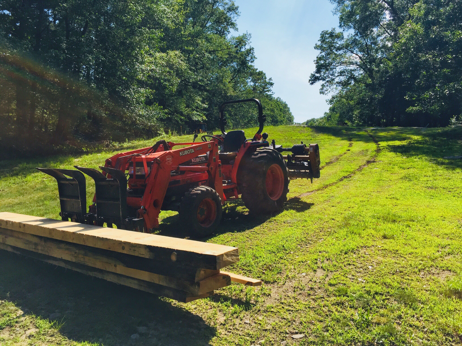

2wd vs 4wd. A picture is worth a thousand words.
