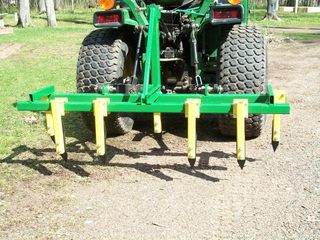

wyo, you're doing the same thing I did/still do. Once you build the hitch, you can build all kinds of tools off of a piece of 2x2 tubing to work out of it. You're getting the job done and not spending anything compared to buying factory made implements. For my plow like you made I took 1 cultivator leg off of a set in the bone yard and welded it to a piece of tubing, it has the angle adjustment. I took 4 teeth out of my boxblade like you have there and put them in a piece of 4" tubing, cut the slots and made the pin loops just like in the box blade for what I call my root rake or sub soiler. I have a single tooth that I plan to do basically like you did to run water/electric lines. If a man has a welder, building his tools is very thrifty and some of mine is custom made just to my liking and never seen anything like them. I like to take old equipment in the bone yard to get my parts and rig the correct hookup out of my hitch to get what I need. Every time I think I'm going to buy a piece ready made the price usually scares me enough to get my mind working and build it.

short game, it only takes a short piece of 2" tubing to get out of your hitch and then you can let your imagination take over. I have 2x2 tubing and an 8' stick of 2x2 solid stock. If it's going to take tough treatment I use the solid.
