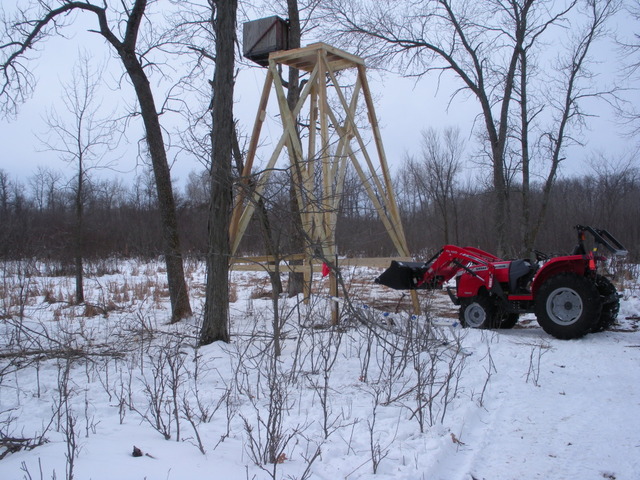

I'm kicking around the idea of building a gun tower stand but am having some indecisions about the base legs. I wanted the legs(4 of them) to be 24 feet long but I can only get 4X6's up to 20 feet long so I was wondering about laminating three 2X6's together to make the legs(like a beam) The question I have is with staggering the joints. I was thinking about using a 16 foot 2X6 in the middle and filling the ends with two 4 foot pieces and then using two 12 foot pieces on both sides of the 16 foot and the two 4 foot pieces. Should I stagger the joints more or will this be ok? The joints on the outside of the beam would line up. The legs will not be standing straight up and down the will be kicked out about 10 degrees. Cross bracing will be done to the base also. Thanks.

OK, so I have another staggering option. Put two 12 foot 2X6's in middle and on side start with a 3' 2X6 and then a 12' and finish it with a 9', and the other side I would start with a 9' and then the 12' and finish it with a 3'. Does that make sense? Then the joints would not line up at all. I would screw them together first. I am planning on using carriage bolts to secure the cross bracing and going all the way through the legs and bracing. Afterwards I will place more cariage bolts on the legs(beams) where I think they need them.

Well, I finished my base yesterday and hauled it out and stood it up. The legs ended up being 22' long and were made out of three treated 2X6's bolted together. I pulled it over with the tractor and had two four wheelers with winches hooked up to the opposite side to let it down gently. Everything went really well.

Nice!! now all you need is a big water tank:laughing: Seriously, looks heavy duty, should be comfortable for years:thumbsup: Ah..er,, wheres the elevator/stairs/ladder.
Is that a tree blind hung in that tree? nice and high.
