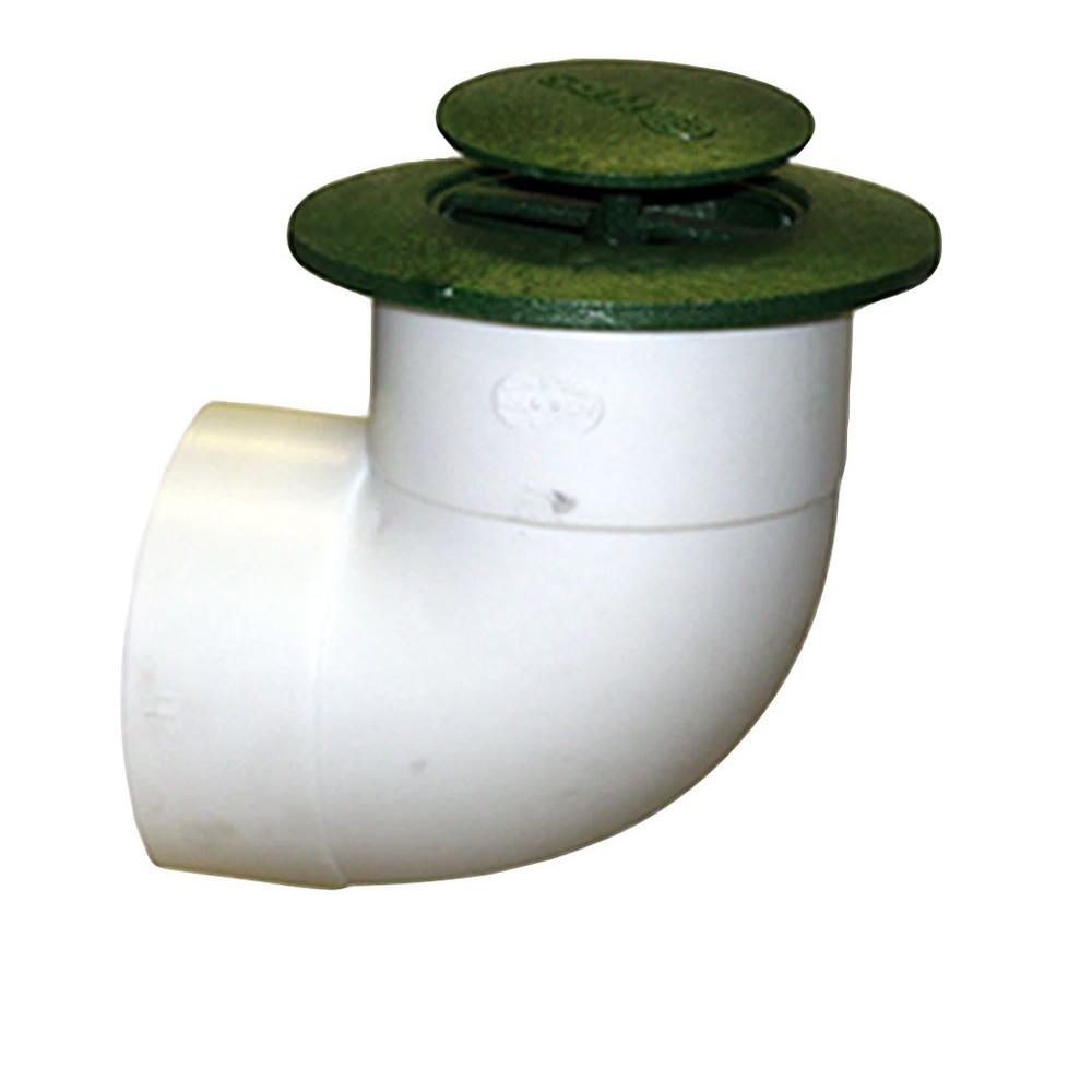

I run some of my gutters through 4" pipe to a place in my yard lower than the house.
Then, I terminated the pipe with these, flush with the yard,,,
4 in. Polyethylene Pop-Up Drainage Emitters with Elbow-422G - The Home Depot
When it rains, they let the water out,,,
when it is not raining, the top is flush,,,
I run them over with the mower,,, all the time.
I have had several for about a decade.

I'll look into those may be the way to go with the front yard I do have a pretty good grade there. Would it hold up to a 4000lb tractor running it over? If I put one in the back yard it's guaranteed to happen eventually.
   / Gutters and french drains #20
I have accidentally run it over with this,,, a "tad" over 4,000,,, :laughing:
You kinda forget they are there,,, I would not do it the first year,, or regularly,,,
Occasionally, you have to lift the green cap out of the elbow, and clear the leaves.
I am always amazed, the little pop-up always goes back down, and never hangs up,,,
Right at the bottom of the elbow, drill a 1/2" hole.
that way, water will not remain in the pipe.
