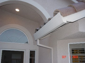

I saw these gutters on my mom's house in Sacramento, but haven't seen them anywhere else in the country, I like the fact that they completely cover the fascia board, in fact, you could use these in place of a facia board.
Oops, I'll have to resize first, back in a minute with the pic........

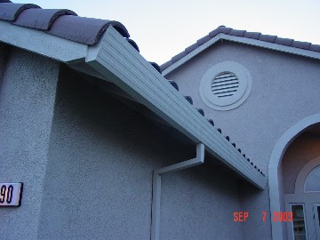

Another pic.....
