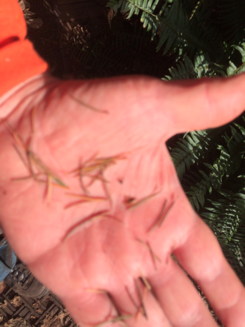

Fir needles don't behave like pine needles.
Bruce
