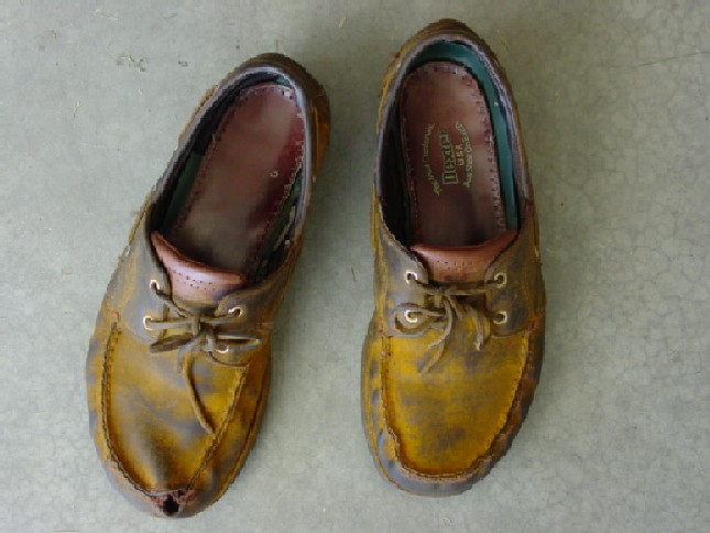

I am hopeing with a few cuttings you will like the Gators. Mine is a side discharge and you would never get me to change my blades for anything else. I have much smaller clippings now and am finding that the grass clippings decompose so much faster. In fact years past I have had lots of trouble with rust on my lawn which is partially from a build up of grass clippings. This year I have no problems with rust. Now the weather has a lot to do with rust which may also be why I have none this year.
Pic is of my shoes after walking across my lawn last year. That is how bad the rust was.
murph

When you wear iron shoes, what do you expect? /forums/images/graemlins/smile.gif
All seriousness aside, I live in the "Rust Belt". Here in Cajun Country, the dew is so heavy every morning that we can't even grow certain typs of grass. Rust absolutely destroys zoysia here. Dense windrows always have rust or grey mold under it.
