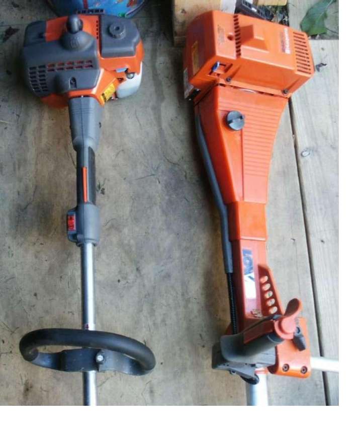

Now the but....do you need that much better? I have the previous model (245Rx) brushcutter and a 326Lx trimmer. My 245 is a pound heavier than the new 345, but the 345 would still be a heavy piece of equipment without the harness. I generally use the 326 with heavy string for the light stuff: tall grass, & brush. I keep a steel blade on my 245 and use it for the heavy stuff: saplings & small trees up to 6 inches in diameter. Yup the 245 is a beast, basically a chainsaw on a pole. So it really depends on what you plan to cut. I think a smaller saw like the 326Rx would do the job for 99% people, but the 345 should last forever.
