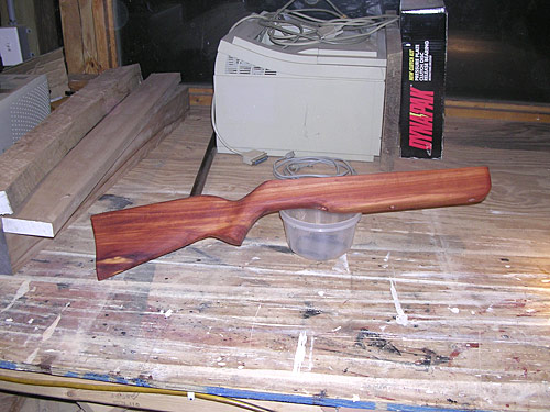

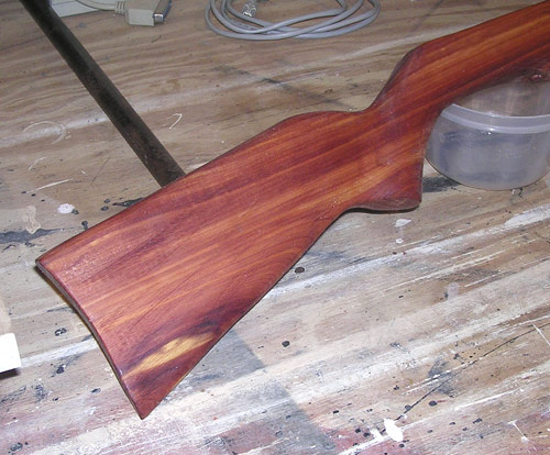

Few years ago my son wanted a toy rifle for Christmas. I always prefer the real thing:) - digging through my magpie pile I found old barrel from 12 gauge shotgun and used that. The stock I copied from CZ made air rifle, but the only piece big enough for the stock was a chunk of cedar. I only have pictures of the stock, but here it is.

Nice work with the cedar.
I really like the color of cedar but around here, the only way to get it is to go to the store and buy it and that gets expensive. I wanted to start with a 3' log and go from scratch.
My only other concern with cedar is (correct me if I am wrong) it isn't a very hard wood.
   / Hand Made Gunstock #14
You are absolutely right. Cedar is very soft. Pretty to look at, but for rifle stock the toy gun is about all I would use it for.

It's deffinatally coated heavy. 2 spray cans of minwax poly. About 5 coats per can. Wet sanded after the first can was gone and then again before the final 2 coats.
All told I have about 30hrs in it. If I had a mill, It probabally would only have taken a day to make and another couple to coat, with the waiting in between coats.
