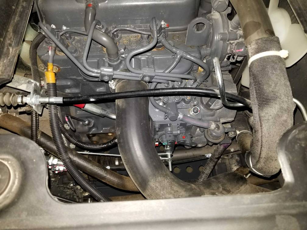

I'm an idiot. That's shift linkage.
   / Hand throttle for 2016 RTV X1140? I can't find one....Is it a unicorn? #12
The cable in your pic looks awful big to be throttle?? Are we sure it isn't buried deeper in there somewhere?? :(

Hard to say. Are a fabricator (cobbler)? The principle is going to be the same. You may have to rig up some bracketry at the injection pump as well as a method to hook up the cable end. In my setup when I use the foot pedal the hand throttle cable just falls slack, nothing high tech about it at all.

What surprises is me is that you've read in the manual about the hand throttle but can't find one.
Is your throttle a simple lever on the injection pump that your foot pedal cable moves?
If so, the "cobbling" I talked about above might apply.

Looks like there is space on the throttle lever on the engine to add a second clevis for the added cable.
You need to see if you can add a bracket for the cable end to mount on, a intermediate support for routing the cable so it does not, rub, move or come in contact with the exhaust or moving parts and not kinked or too tight of turn, and a place to mount knob and base that is easy to get to and not in the way.
The hand throttle on earlier models was mounted near the hydraulic lever for dumping the bed, you may see if there is a plastic plug filling a hole already there.
