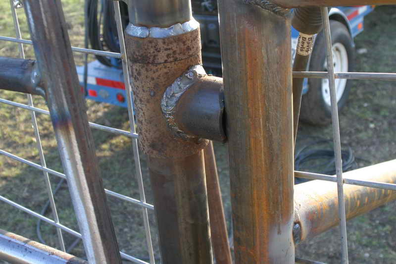

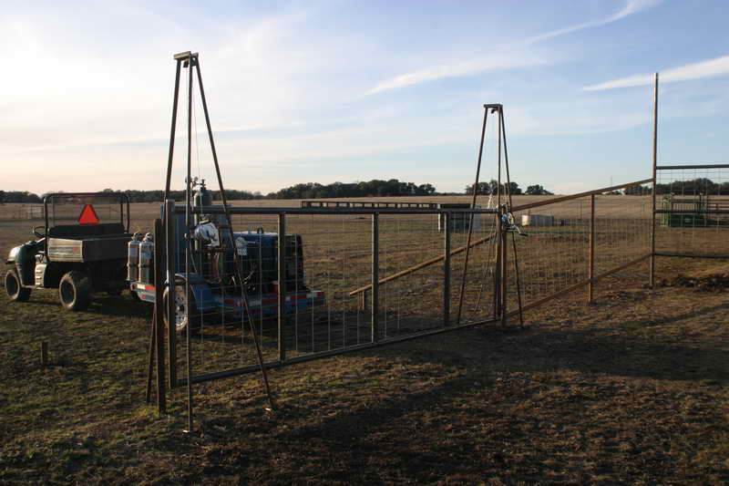

I'm just starting a corral project and have about a dozen gates to hang. I usually hang them in place with the tractor FEL, put some blocks underneath, shim things until it is about right and weld away. But that's hard to do with just one person, so I built a couple of tripods with winches on them. I still set them in place with the tractor FEL, but use the tripods to get things just right. It's quite a bit faster and turned out pretty good. I'm curious if anyone else out there does it like this or has something better.

I hang mine the same way you described except for the tripods. I think you must have some pretty large gates.

Looking good. Nice heavy gates, guess you have big cows down your way.

Really like your hinges and the tripod idea as well. Sure would make working alone alot easier, that's for sure.

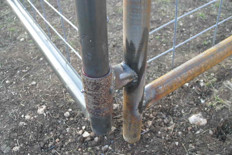

One thing I noticed on the pic of your lower hinge, have you considered welding a collar over the top of it, like you did on the top hinge, to keep water from getting in between the hinge and the gate vertical post. Just a thought.

I debated the issue of water getting into my hinges long and hard. On the bottom hinge, there is a collar below it, but not one on top. This is to keep the gate from being lifted up as some cows will try to go under things when they are confined to small pens.
I opted to put the collar on the bottom side and leave a small gap to let any water seep out. No solution is perfect. There is always a down side of some kind.

Like the tripod idea.:thumbsup: That and you do some really nice work. One thing though. Welding it to the post seems a little to permanent for me just in case you decide to make some changes, the posts settle and lean a bit, or the gate gets damaged. Just some thoughts.

wont grease help the water issue?
Well if any of that happens, I'll just cut it off and re-weld it. :)
