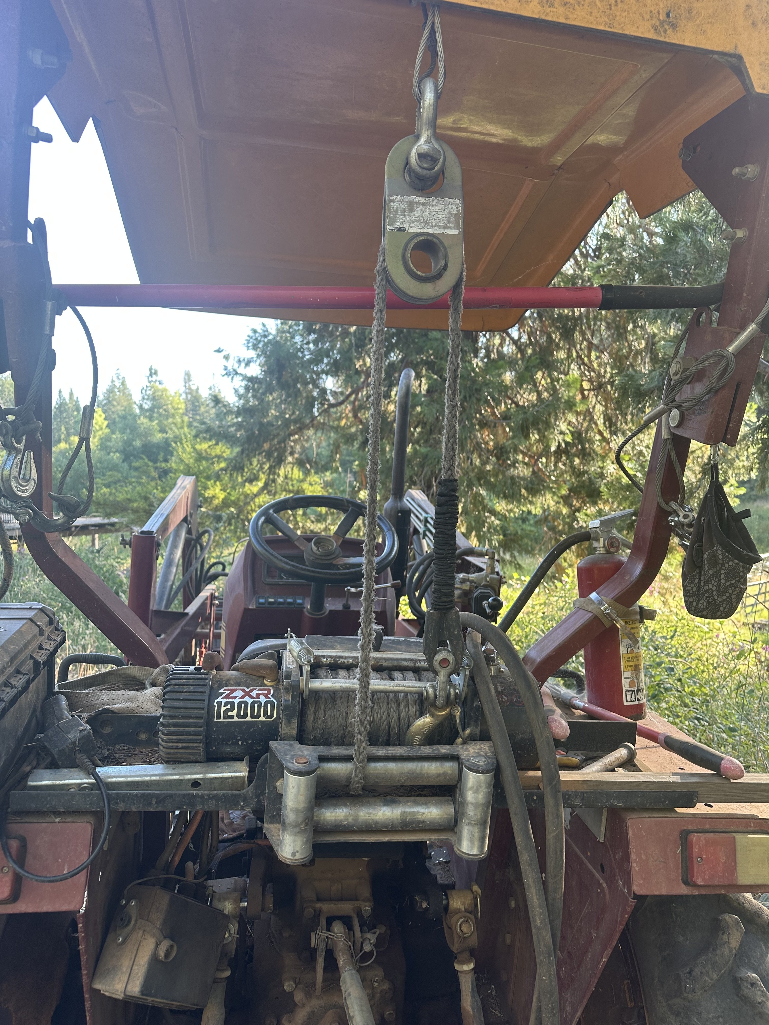

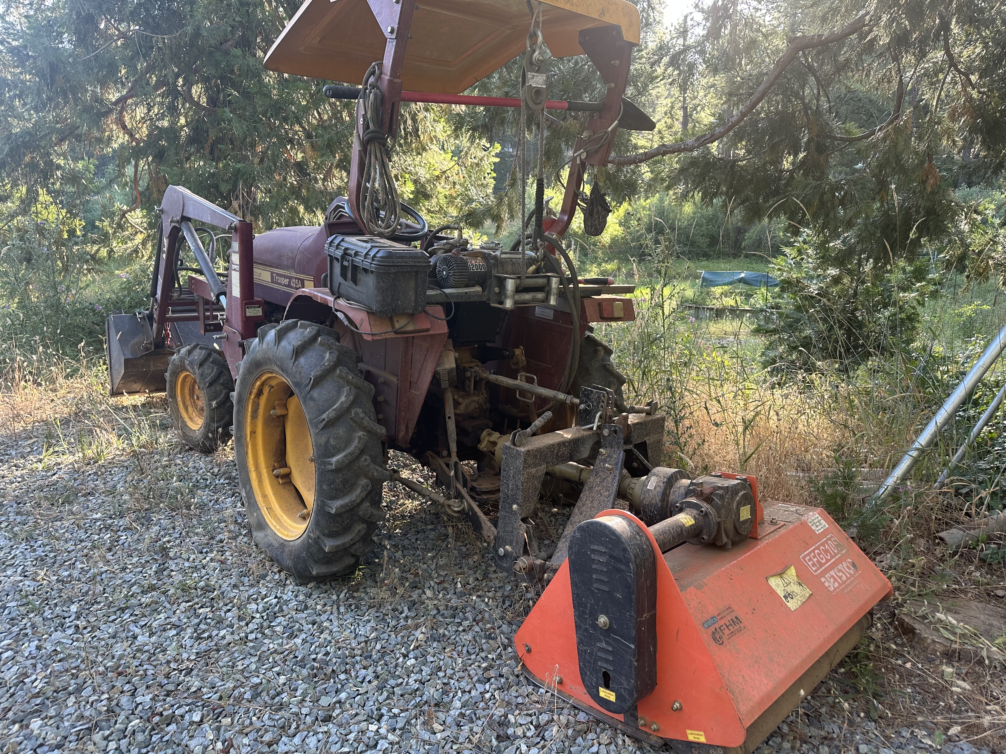

A few years ago I got my 4WD tractor stuck in axle deep in mud. Tires just loaded up and spun. Tried using the FEL to lever out but that got nowhere. Bought a 12,000 lb. Harbor Freight electric winch and added it to help pull it out while I drove. The synthetic winch line is easy to handle and has no fishhooks like steel cable does. The snatch block on the ROP frame makes it easy to lift the flail mower to clear the junk I wrap up by accident. Or lift one end of big logs to drag them around. The mounting bracket attaches to stainless steel parts I welded together and bolted to the lower ROP rectangular tube frame. This addition made this 25hp. Chinese diesel tractor a real work horse. Here is the result:

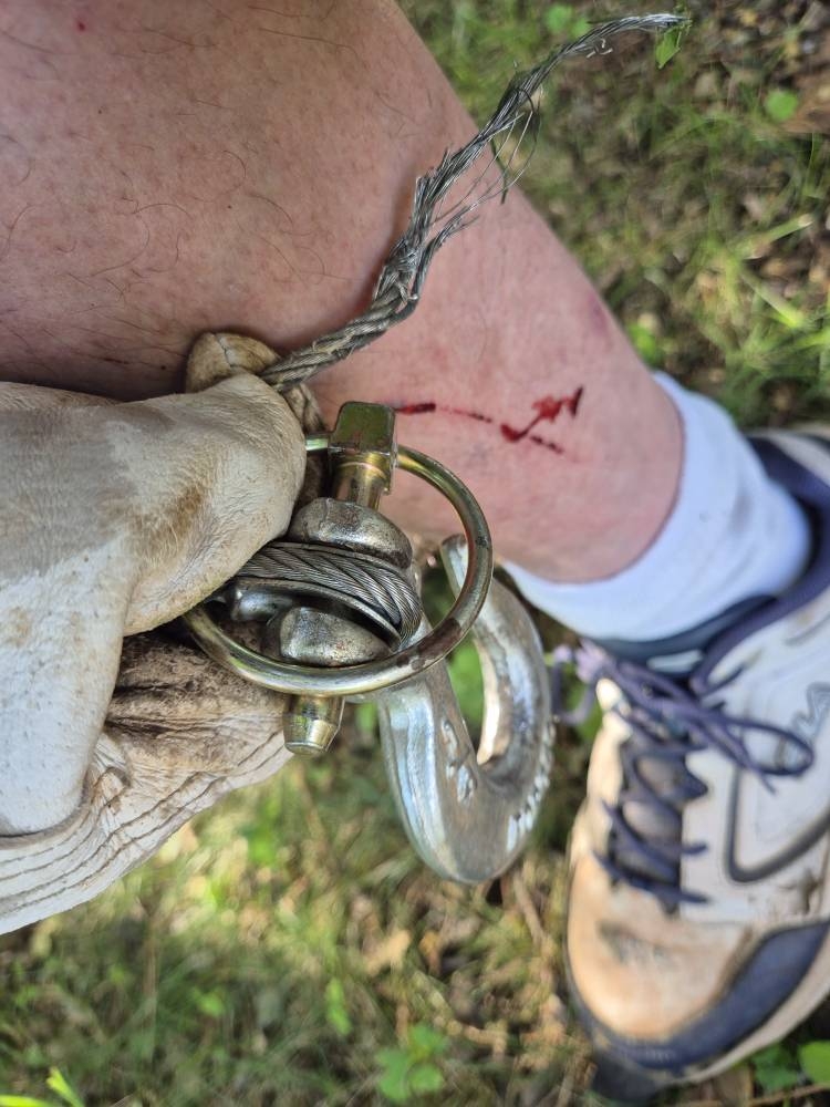

This afternoon my 5,000 # HF winch snapped.
It may have 2 hours on it...I need a better one.

I like the winch on the rear to pull out backwards!

I am trying to understand mounting the winch that high for recovery purposes. It seems mounted that high could tip the tractor backwards unless an implement is on the 3pt.
Note the lifting the implement higher may be useful at times that the OP mentioned.
Does the winch have any tendency to tip the tractor rearward when winching?

I'm really hoping the OP is not using the snatch block mounted on the ROPS to pull in heavy loads.
/ Electric winch #9
He mentioned lifting the implements higher which would be kinda okay.
However, he also said lifting logs to move them and if that involves the snatch block then I agree no.

Considering the white rope broke in 2hrs I think we are going to find abuse of the cable. Also if your wire rope broke do not use synthetic. They arnt nearly as abrasion resistant as wire.
/ Electric winch #12
How was it rigged? Was the cable wrapped around something with the hook on the cable? And what's up with the lynch pin?

I was wondering about the winch being mounted on top of the FENDERS! Hopefully the other end of the block and tackle is hooked to the drawbar to give it less chance of flipping the tractor!
Overall, a winch is a great thing to have on a tractor, either full time or set up to quick connect when you need it!

The lynch pin is just a rig job, the original pin fell out somewhere. Winch is mounted on tractor front weight bracket. I'm thinking where the cable snapped was I winched a heavy log then lifted a bit with FEL so I could drag it.

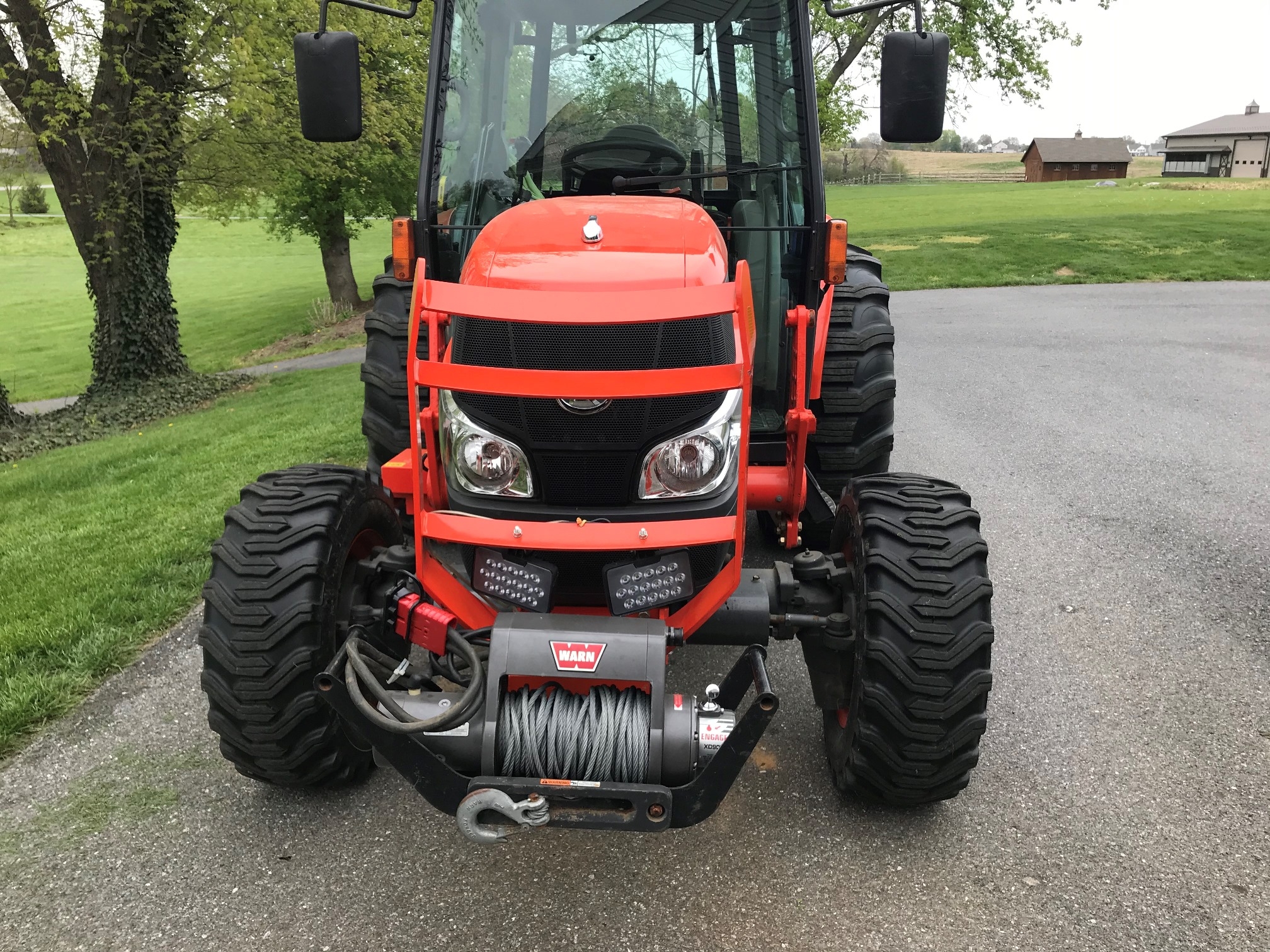

A few years ago I lucked into a Warn on a receiver hitch. It made me rethink mounting. I've had one winch or another since the mid-70's. All were permanently mounted (out in all the weather). First was an 8K Belleview (power in only), then a Warn 8274 that #3 Son now has on his Cherokee, and finally the Warn XD9000 with wired and wireless remotes. Exposed mounting can cause more than just cosmetic damage. I suppose many prefer prominently mounting a winch and traction boards, rotolok cans, HiLift jacks and other doodads as either a fashion statement or an attempt to portray themselves as real off-roaders when they cruise into the grocery store lot:)
There's also a smaller 3K(?) HF for which I made a mounting plate with a wireless remote. and use for lighter work. It's handy on the loader bucket receiver. The 9K winch, Trailblazer and Kubota all have 350A Anderson connectors wired in with 2/0 copper welding cable. A while back the original steel cable on the Warn was replaced with synthetic.
There are also two 2/0 extensions. One is 25' long and has Anderson connectors on each end. The other is 5-ish feet long with an Anderson connector on one end and Vise Grips on the other. The shorter extension with the Vise Grips provides an exceptional connection to the "jumpee" or use one of the winches on another vehicle. The long extension allows me to park behind a vehicle that needs jumped or winching from either end of the Trailblazer.
The small winch has a permanently-installed harness made from about 12' of a pair of maybe #2 from an old pair of jumpers and an Anderson connector. When used on the receiver of the bucket. it is longer than needed to plug into the tractor.
