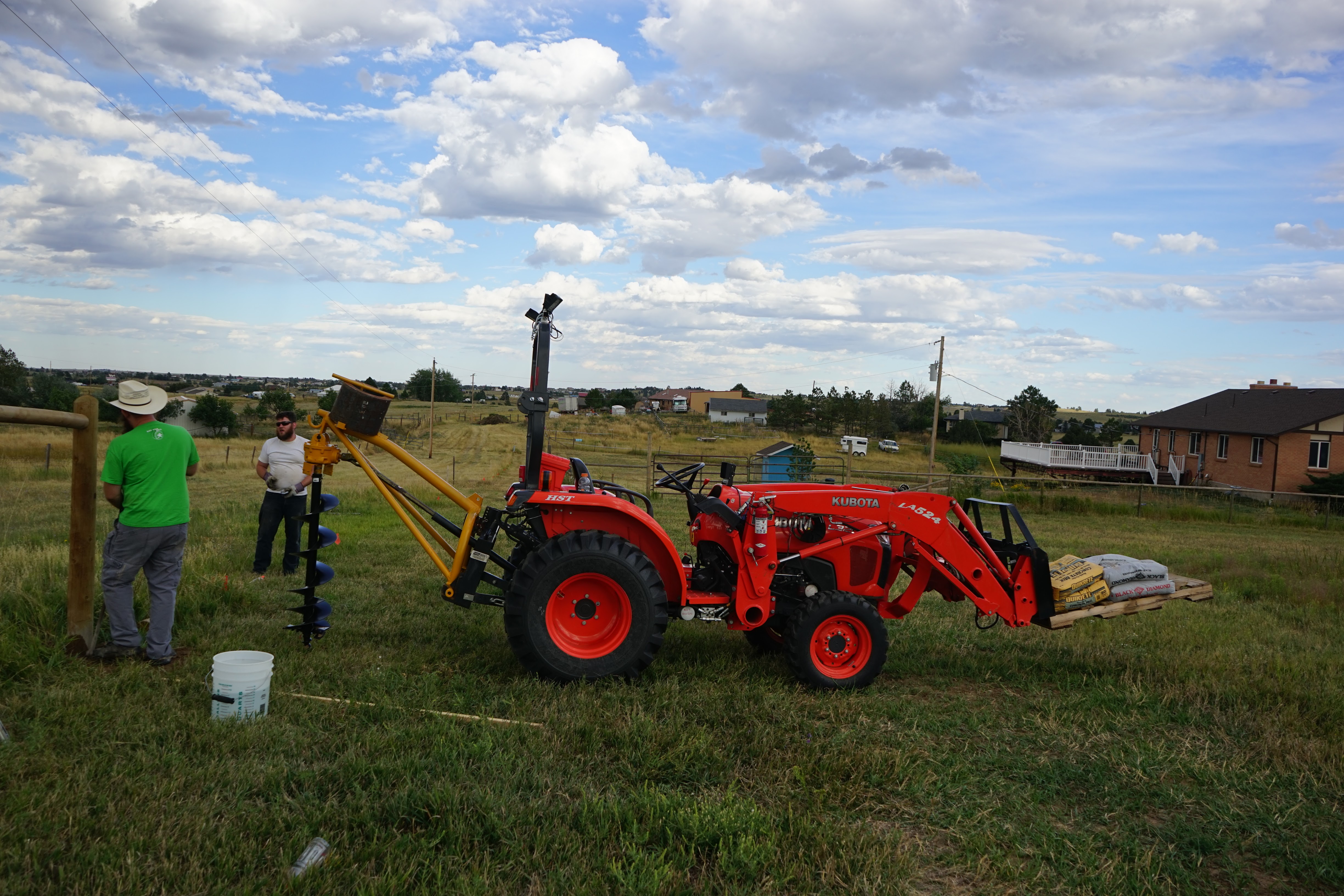

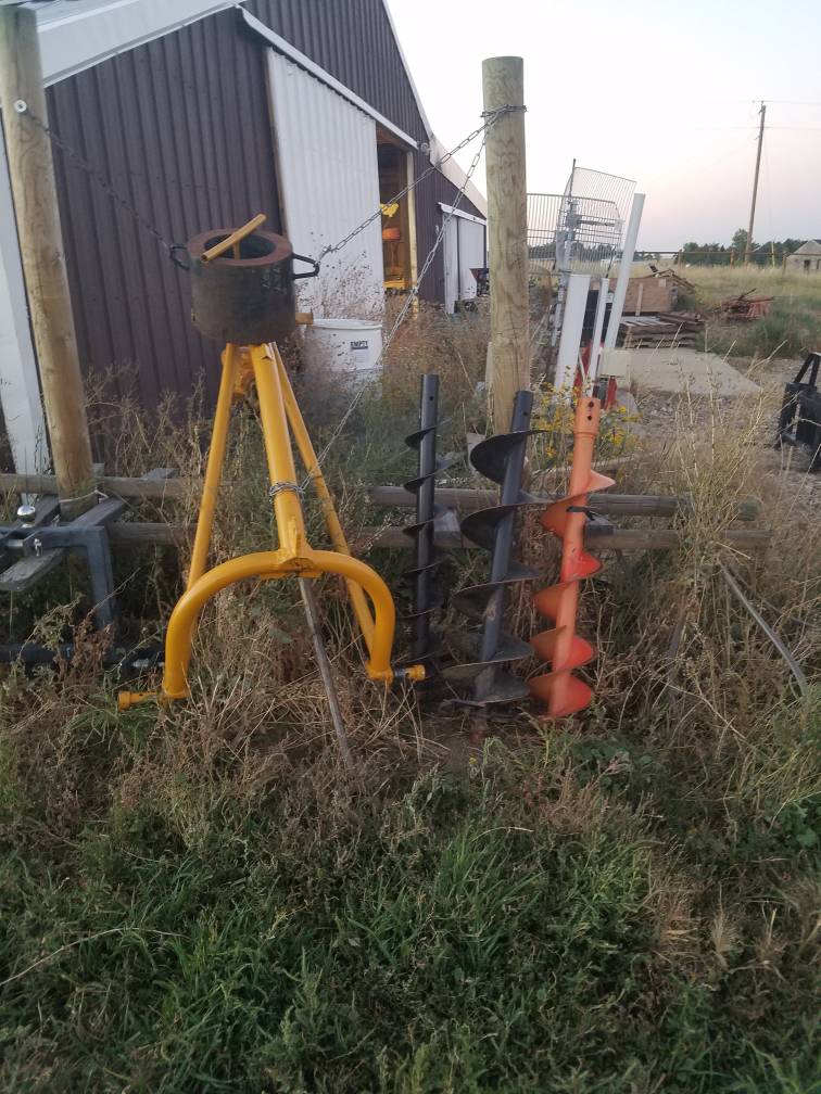

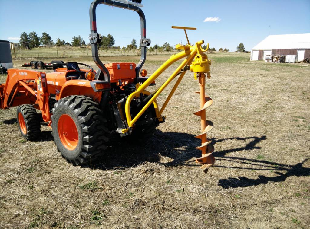

It was easier to hitch up with the QH, but still not super easy, especially compared to the hydraulic SSQA one on my new tractor.
I didn't get the angle quite right & would bend the PTO shaft of I lowered the 3pt without extending the toplink when there was no auger on or it was part way in a hole.
You absolutely need a hydraulic toplink to do this. A PHD is a lever, 1' of 3pt movement translates into 3' of PHD movement. With the QH removing the lever aspect, you need the toplink to act as a lever or extra lift & get the travel for a full sized auger. The hydraulic toplink does give you down pressure on the first 1-1.5' of hole. Not sure if that could damage things due to unexpected forces on the 3pt. I never had any issues.
I added extra bracing to mine when I welded it up. That also let me add 200lbs of scrap steel over the gearbox for extra downforce.
It was a good project & I don't regret it. But I sold the PHD with my old tractor. As I do side work with my tractor, I've barely been able to justify replacing it with a hydraulic SSQA unit. I don't regret it even though it was spendy. My 40hp tractor only puts out 15hp at best via hydraulics. I can feel the fact that's half the usable power my old 32hp machine had on the PTO. The ease of hitching, down pressure & reverse make up for it though.
