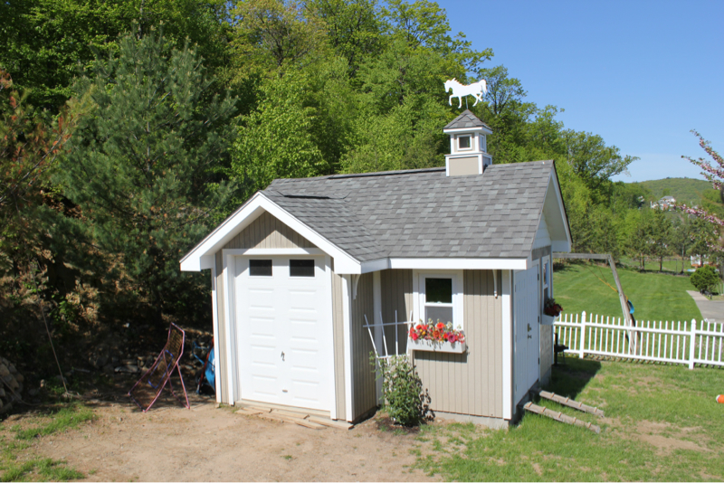

When I bought my tractor I was facing the same problem. I put four 4x4 corner posts in the ground about two feet deep. I nailed four 2x4's between them around the top. I nailed a tarp to the 2x4 perimeter. When I pulled the tractor under it, I just propped a 2x4 on the floorboard of the tractor and passing through the steering wheel to keep it from falling over. This 2x4 was just long enough to push the center of the tarp up, so it was higher then the perimeter, to keep the rain from ponding on top.
That lasted long enough for me to build my shed.
