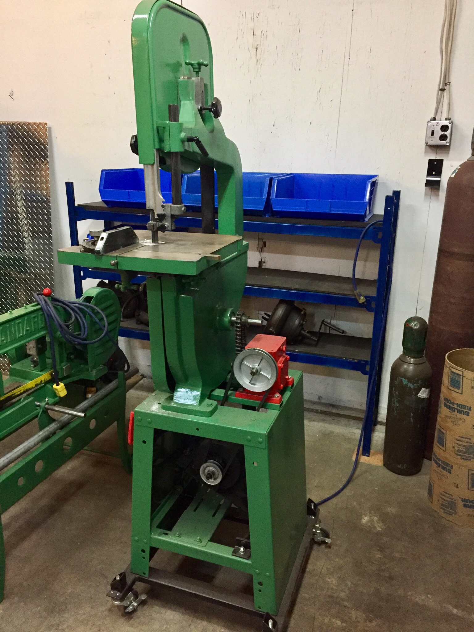

I would have to agree with you regarding over tightening of the belt to reduce slippage.
I used a gear reducer on my vertical bandsaw to reduce blade FPM for cutting steel.
   / Harbor Freight drill press mod- lowered rpms to 200 to improve results drilling metal #15
That idea I like, must study my installation carefully to see if I can adapt your solution as I have a couple of reduction boxes and in fact even a variable speed unit.
Now if I could only reduce my press drill speed as easily as this bandsaw solution.
