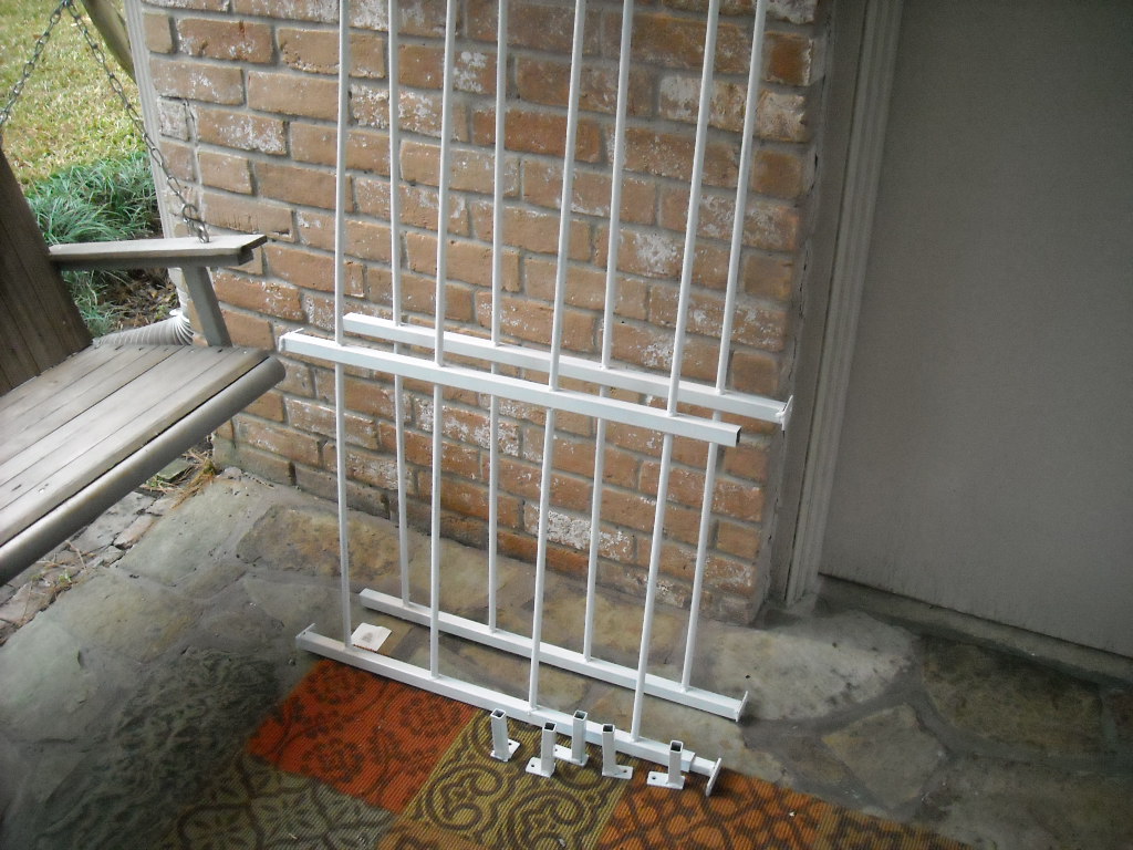

   / Harbor Freight Flux Core welders #88
:)ROBJ, sorry man,but it sounds like you need a security system instead of a welder. zman
In progress!! Lights, Gates, more locks, noise maker.
Insurance helps, at least you can replace the bad with better, just pay the difference. AND make sure you have enough coverage.
Rob
