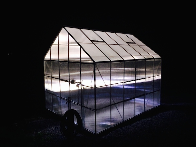

Power on! Night shot...

That just looks so well done. If you had that around here you'd have families living in it :laughing:
I wouldn't expect anything less from you. That's a super job. :thumbsup:

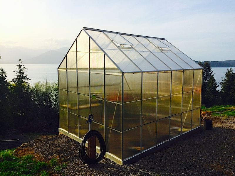

Thanks Paul! Yeah some of the detail is a bit of overkill but you know how perfectionists are! :D Here is a day shot with some diffused evening sun. Note the auto vent openers doing their job even though it is only 60degF outside. It is a nice sauna! We are thinking of adding a couple of plastic chairs and a few overhead misters and we will have a tropical paradise right here in the cool NW. :cool2:
Now I better do a little landscaping around it so it isn't an eye sore.

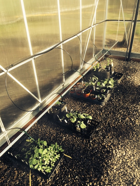

An update and a couple of 'action' pics.
The Univents are working great! We had an 80degF day today here in PNW!!! Near record temps I think. Vents are opening and closing wonderfully. Starts are sprouting and I installed a misting system on a rod that I can raise/lower and it is on an auto timer. I left them for 4 days and all is well so the goal of automation is working! I do think I will need a powered/louvered fan for the summer heat though.
