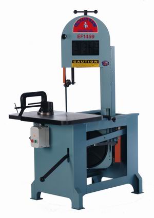

The Harbor Freight saws are very popular and if you don't mind tinkering they can be made to work well. However, buying one can be a crap shoot. Since I'm at the point in my life that when I feel like working I want my tools to cooperate, I bypassed the HF saw. I bought a used Roll-In EF1459 bandsaw instead.
The Roll-In is a horizontal bandsaw, turned vertical, with a large horizontal work table and a vise/fence that can be used to position and clamp the workpiece. The movable saw platform is on a track and is gravity fed. It can be automatically fed against a clamped workpiece by gravity, damped by a hydraulic cylinder with an adjustable needle valve. It can also be used as a conventional vertical bandsaw, by leaving the movable carriage stationary and sliding the workpiece on the table against the blade.
The Roll-In has been a great saw for me. The only maintenance it's needed was routine lubrication and installing a longer power cord. After many cuts, including 6" solid cast iron and steel rounds, I'm still using the original bimetal blade. It's heavy but it came mounted on wheels so it's easy to move and sweep under. New Roll-Ins sell for $3,995 but I've seen several good used ones sell for about what I paid for mine ($750). They are made in USA.
