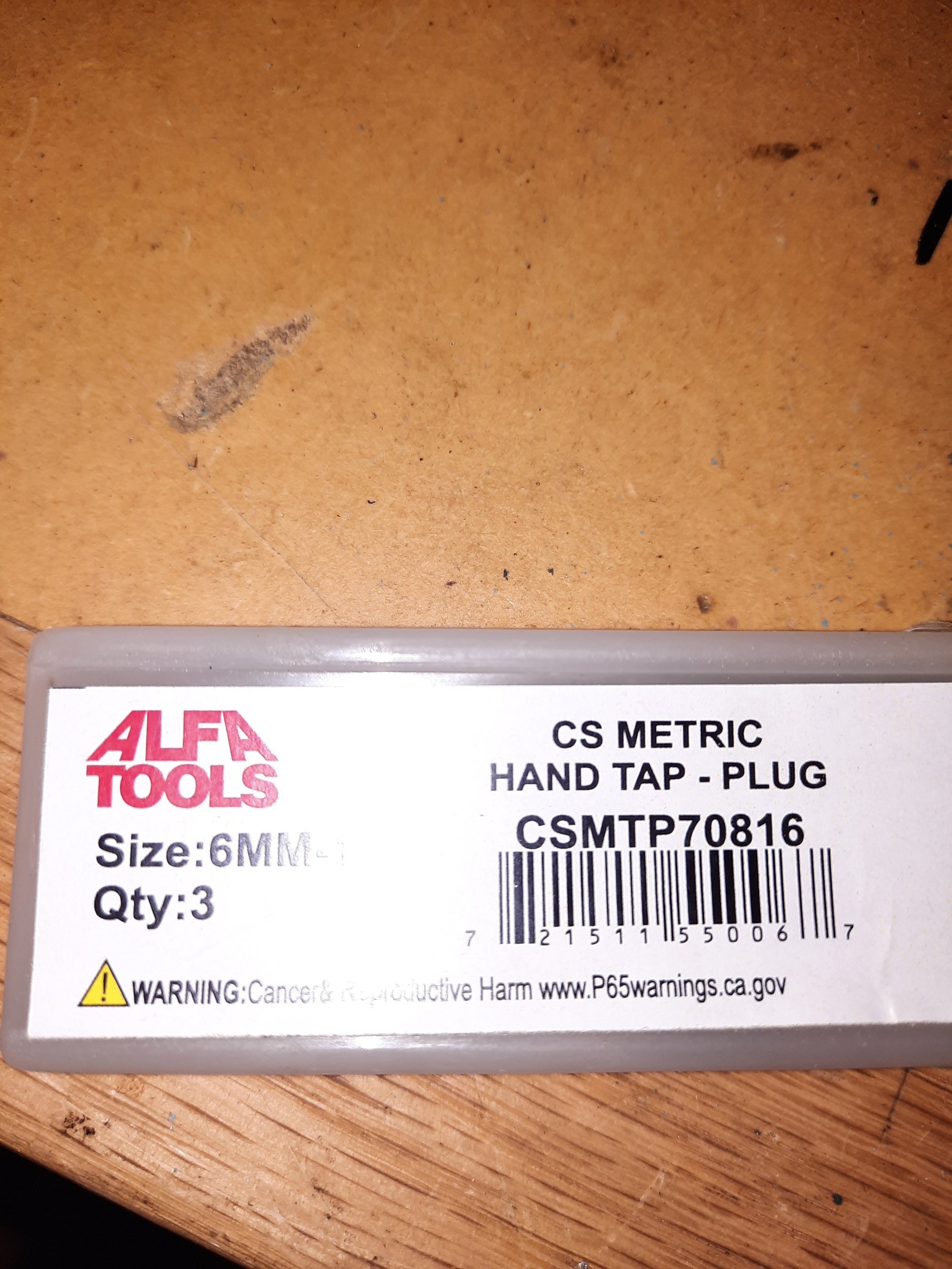

Not sure how I "boogered" up the threads on my tip holder on my Titanium 125 but I cleaned it up with a 6mm tap. The industrial supply did not have a bottom tap just the starter tap so I used it until it bottomed out then cut it off to finish cleaning the threads. I'll just pick up another starter tap should I mess it up again if they have it in stock. This was the last one that they had. View attachment 878223
Most likely because you ran the wire with no stickout and it fused itself to the tip.
