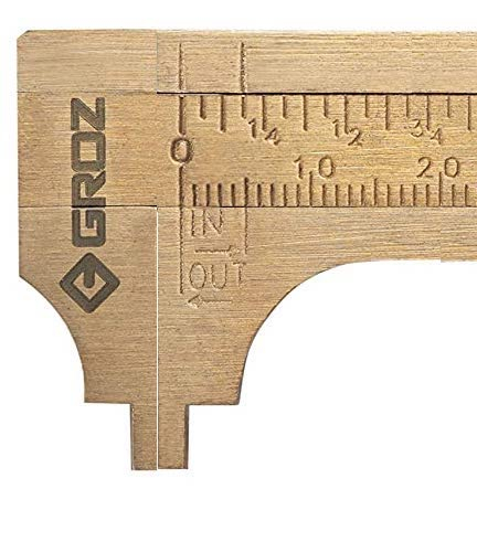

When the calipers are closed, the "OUT" line lines up with the zero.
Cut and paste to show it:
Bruce
   / Harbor Freight Tools that DO SUCK II #152
Cut and paste to show it: ....
Yeah but:
Sooner or later that offset would lead to an error . This photo illustrates my point more clearly.
At a casual glance it seems the jaws are open about 0.9 mm.
Nope, 2.6. For a tool I pick up only occasionally, I don't need that sort of unnecessary ambiguity to make a project more complicated.
