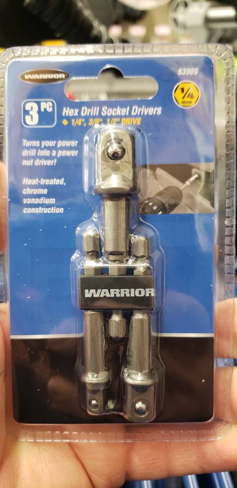

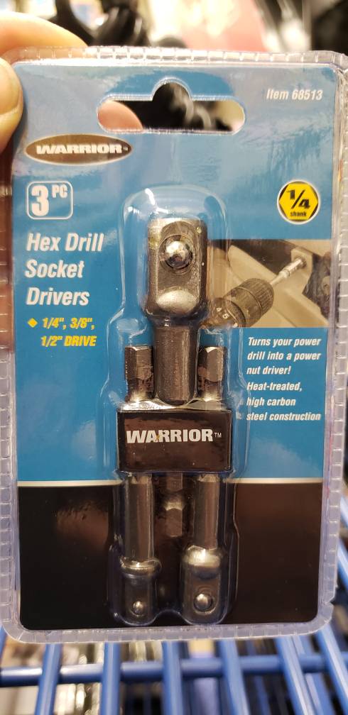

Both the same price, considered by HF to be the same part... But typical of HF, they have different places making similar built and packaged items that all hang in the same hook.
In this case you notice a slight color variance in the labels as well as one touting Chrome vanadium steel while it's sibling is touting high carbon steel.
Question I have.... What is the better too on my 1/4" impact driver? I would think that CV would be more ductile and less likely to break.... Any metallurgical guys on here that would tell me what they would pick for the $4 with 20% coupon? 20190102_153855.jpeg20190102_153905.jpeg
Question I have.... What is the better too on my 1/4" impact driver? I would think that CV would be more ductile and less likely to break.... Any metallurgical guys on here that would tell me what they would pick for the $4 with 20% coupon?View attachment 585610View attachment 585611
I'm what we at work used to call a "Butt Metallurgist" (as in "I'm not a metalurgist, but..." followed by some opinion on metallurgy). I worked in a steel wire mill for decades. We worked with high carbon steel and chrome vanadium. The chrome vanadium is definitely a tougher alloy: it can be heat treated it to higher tensile strengths without getting brittle (there are limits with any alloy, but the limit for most chrome vanadium alloys is higher than for most high carbon steel alloys: that's why you go to the extra expense of the chrome alloy). We used chrome vanadium when a customer needed higher strength, but didn't have the option of simply going to a larger part to get the strength (for example, when weight or space was at a premium).
Having said all of that, it's all in the quality of the steel and the heat treating. Chrome Vanadium is less forgiving of poor heat treating. So this will depend on how well these folks have control of their processing.
