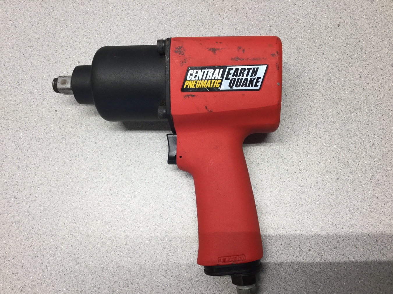

This sucker needs to be used with torque sticks for sure to not overtighten.
Or turn it down, mine has 3 settings:
1. "Hand tight"
2. "3/8 ratchet tight"
3. "Did you want the threads pulled out of the nut" tight
I generally use the middle setting to snug down lug nuts, then tighten them with a torque wrench.

Torque wrench is what I use. If you have an Earthquake and use on lug nuts you eventually will overtighten and strip or bend a backing plate or something.

Where is the 3 torque switch?
   / Harbor Freight Tools that don't suck #10,836
As I said, I use it to snug the bolts down. I stop once they get snug and I always end up tightening them more when I switch to the torque wrench.
On the back of the Earthquake that I have, you have 1 reverse setting and 3 forward settings.
Aaron Z

I have this one;
Like Aaron notes, reverse and three torque settings. I've never needed the highest setting.
1/2 in. Aluminum Air Impact Wrench
