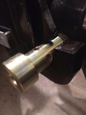

Interesting, thanks, I learned something new.
After the rollpins are driven in, the implement can't be swapped onto a different tractor that has original Cat 1 arms or an early HF qhitch. Seems to me this adds complexity, to no advantage.
Photo copied from a Northern Tool customer review:

You can drive the roll pins out with a properly sized drift punch. I did this after buying a Speeco Cat 2 hitch for my New Holland then taking it back several years ago.
