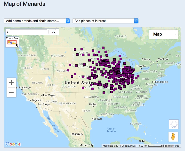

But HF is 10 miles away. Menards is 1000 miles away. The trip would for the savings wouldn't be worth it. :)
Bruce
Not worth the road trip for you, but might be for others who have a Menards in their area. :) I was really just using Menards because that's where I've found comparable decent quality tools, sometimes very similar, to the better HF tools. Obviously they are having them private labeled in both cases, so there are probably other stores doing the same thing.

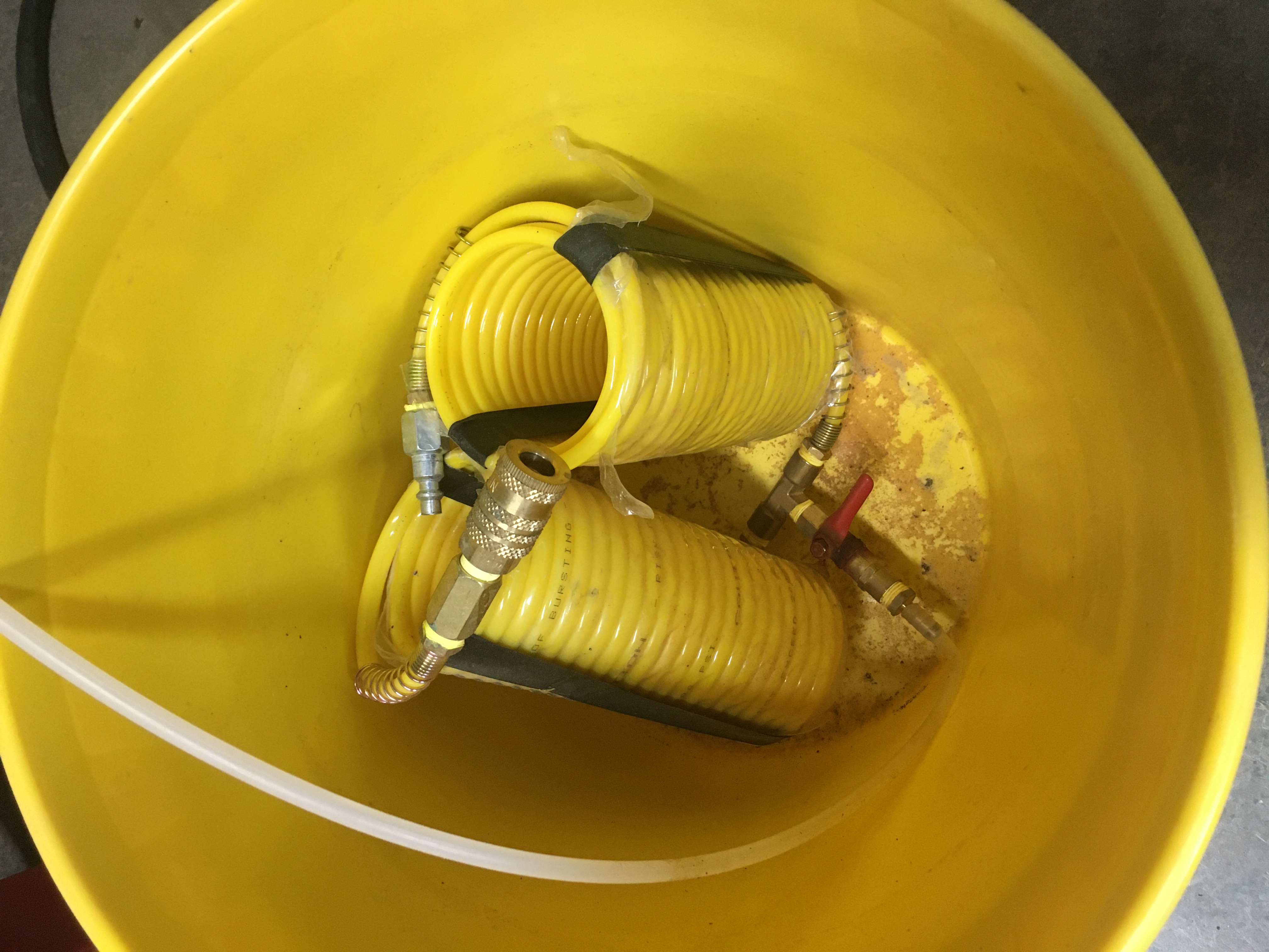

Rigged this up one day when it was humid and the water was killing the sand blaster.
And I got the parts from HF. Fill the bucket with ice water set the valve to bleed slightly
and no more water issues in the sand blaster.

Drain the compressor tank first. So few ever do. Water accumulates then boils back into the air when tank is vented to blow sand or fill a tire. Even then that might not be enough to spray paint.
