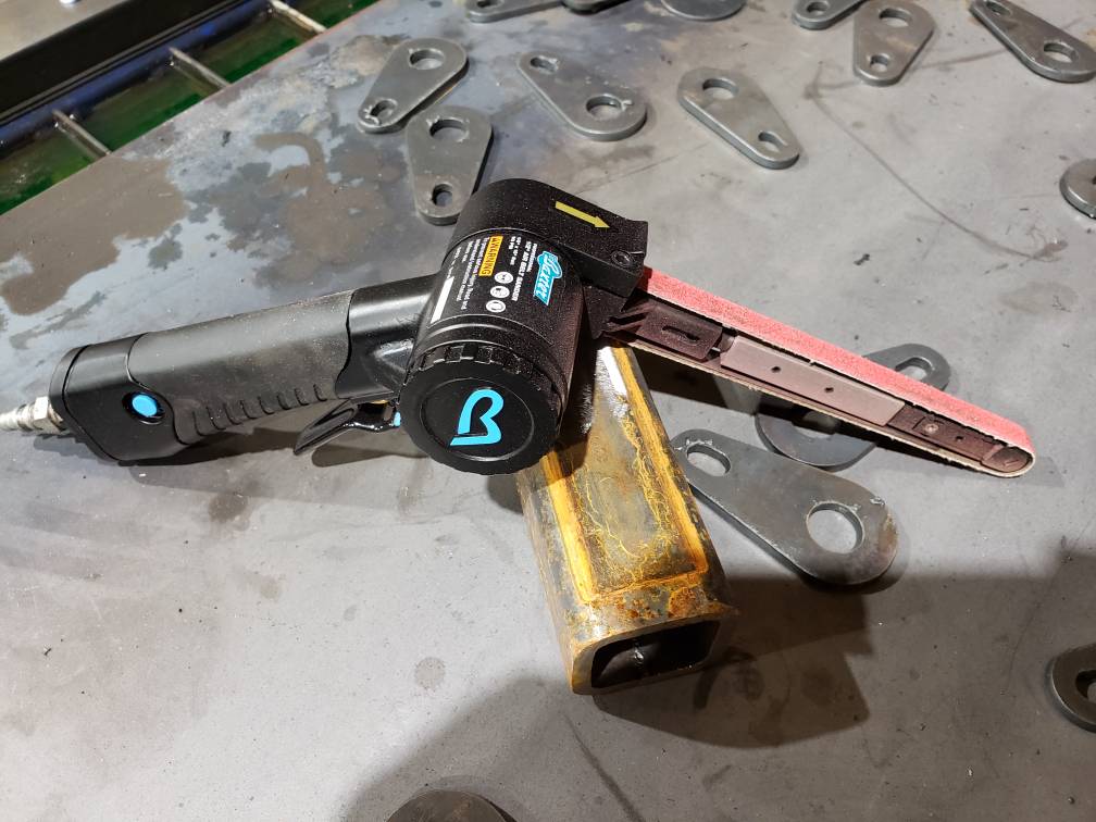

Picked up this profile sander today, it's from the new Baxter line of air tools. Seems really well built, made in Taiwan and comes with 2 ceramic belts that are made in Germany, and the 25 or 20% coupons will work on it.
I only played with it for a little bit to try it out, but so far I'm impressed. 20191231_184922.jpeg

What's the right way to use that? I bought HF's similar electric one several years ago and the foam backing that the belt slides over, soon disintegrated.
Do you sand only with the tip? I was using mine similar to a chainsaw, mostly sanding with the middle of the blade.
Your Baxter does look like a far more competent tool!

It's just sitting on that peice of 2x2 for the picture. It has a metal backer for the bottom of the belt area, I only use them for tight areas/contours, did a great job cleaning the burrs from the inside of that peice of 2x2x1/4 tubing.
You can use the tip or the flat area depending on what you need to do, just have to remember it's not for real heavy grinding, mostly just cleanup/finishing work.
Thanks. I need to make a smooth metal replacement for the inner side of the belt to slide over. HF's design with foam glued in there - wasn't a good design.
   / Harbor Freight Tools that don't suck #12,485
I'll try to remember to get a picture of the belt mechanism when I'm out in the shop this afternoon.

That Baxter belt sander looks like a direct competitor to the Dynafile, it takes the same belts. If you can get the free span belt arm with just the idler at the tip (lower right), you can do contors on butt welded tubing to where you can't tell where the weld is.
Harbor has a very attractive price; Dynabrade is quite proud of their stuff.
