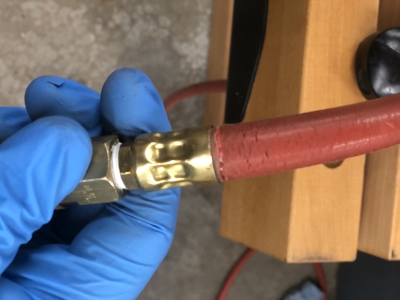

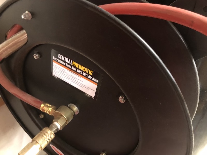

Well my 'don't suck' HF retractable air hose is starting to suck (actually blow). Really liked it but the hose is drying and cracking and now leaking at the quick connect if I bend it so. Not sure how long I have had it but it doesn't see sun and not used daily and it is only about 7-8 years old. Would like hoses to last 20 years at least with easy use... is this an unreasonable request?

I have the identical hose and reel, and the same crack in the hose in the same place. I also have a reel that wobbles but not sure whether it came that way or something i did to it. I ended up replacing the whole thing, but kept the hose and cut off the ends and put on a new fitting. You'll want a 3/8" hose barb to 1/4" NPT

mine hose reel did the same, I replaced all the hose with flexzilla hose and it works great.
