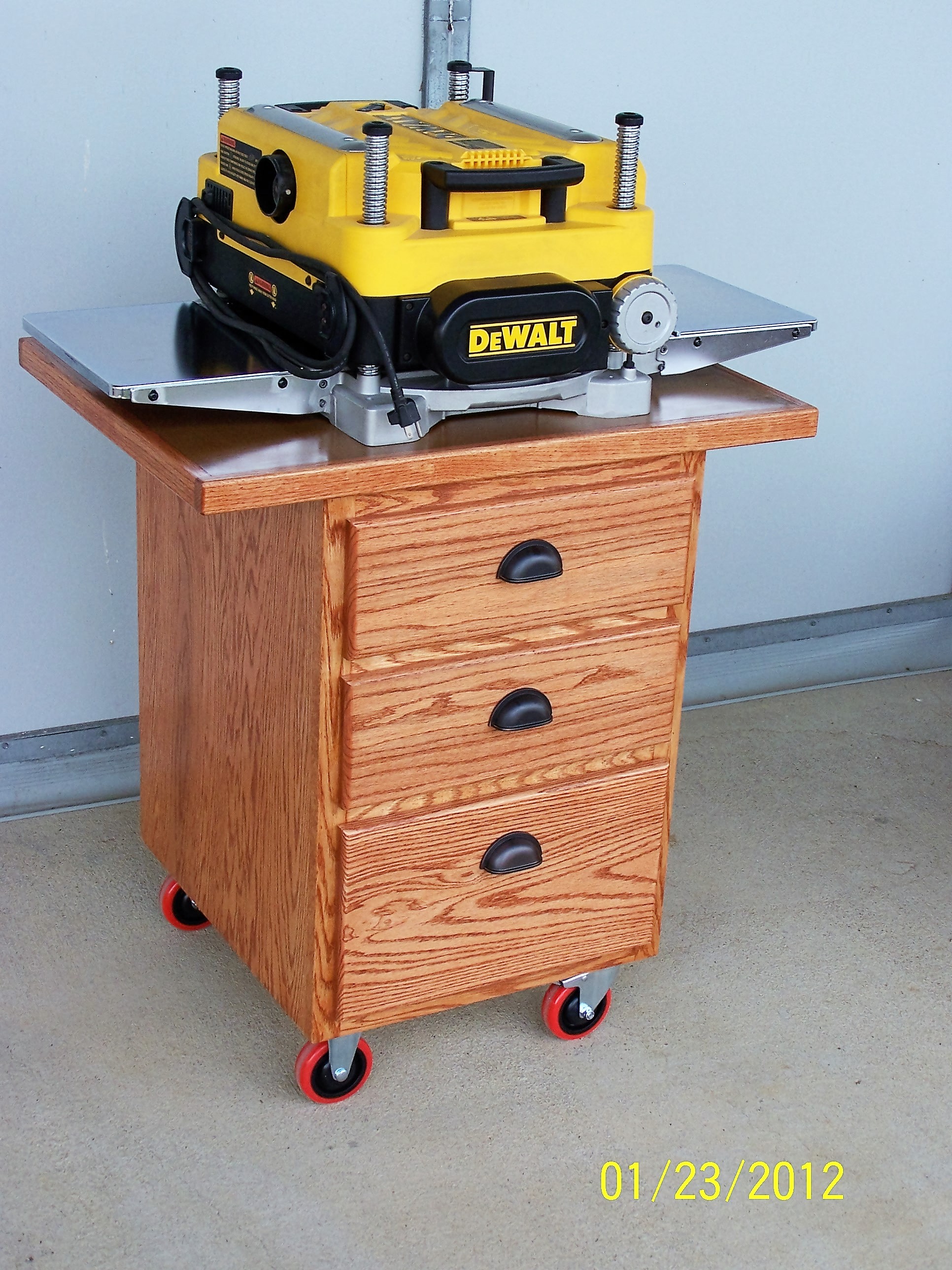

I found that when i connect a vacuum to my planer i get a better surface finish. Apparently, some of the chips fall back onto the board and get pressed into the surface by the following roller.

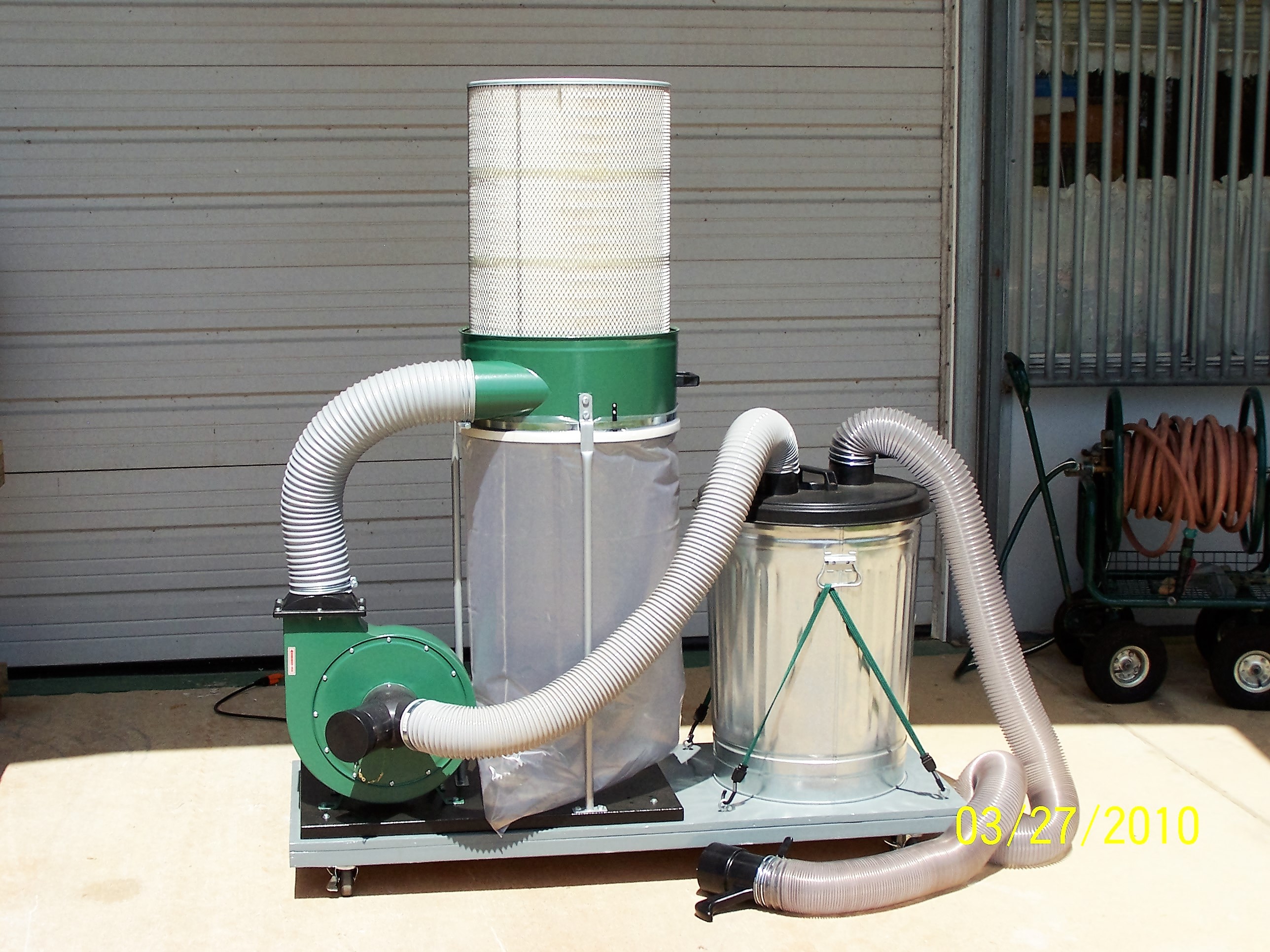

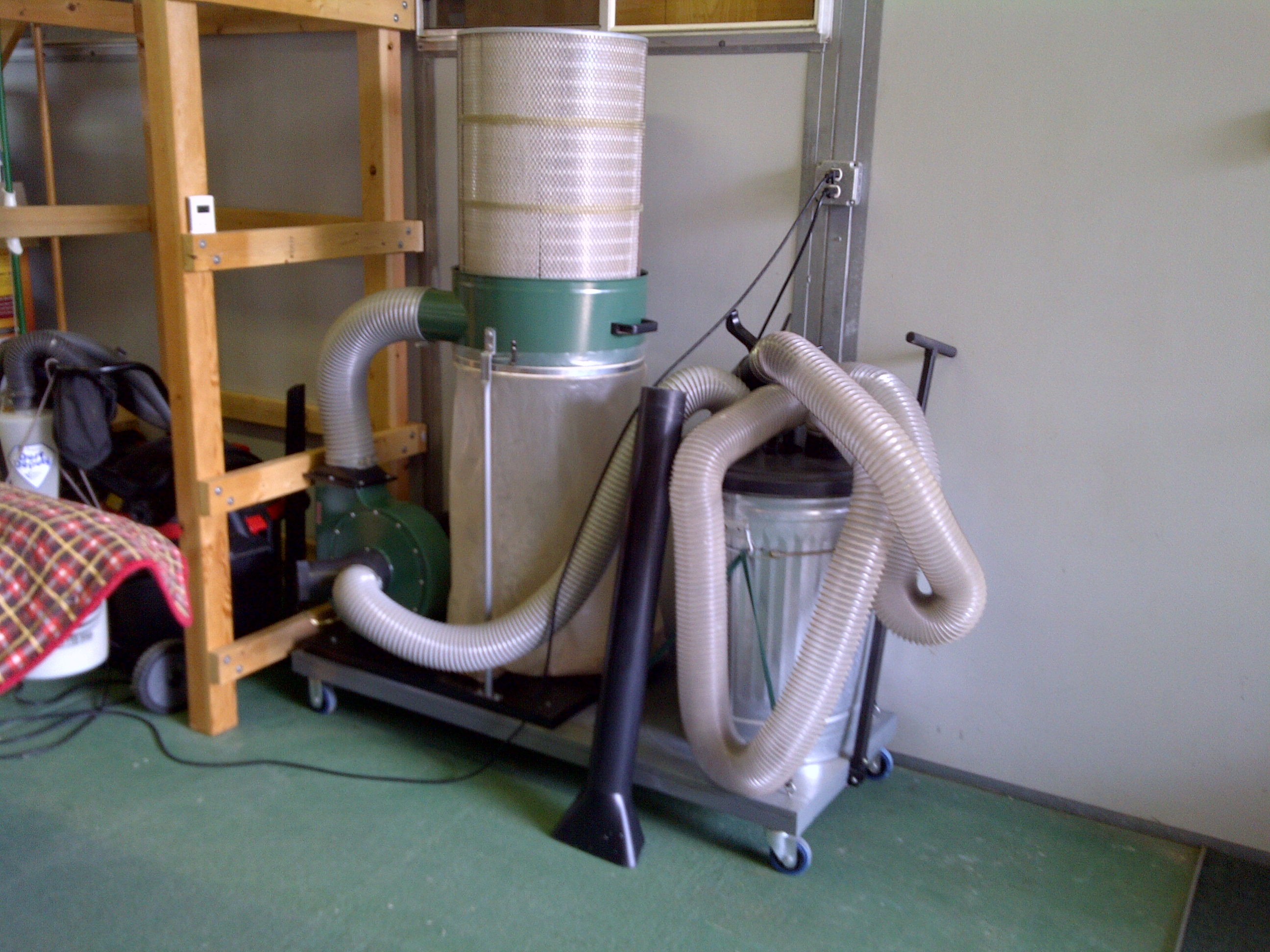

The HF Dust Collector is a good basic design .. but needs a bit of help to make it work well.
I added a pleated filter and a separator top for a 30 gallon trash can so . it's now a 2-stage unit.
I have a long 4" hose I can hook to my planer, table saw, router table, etc.
The cart and bigger casters .. help it's mobility.

That HF unit looks similar to my Delta. I also made another collector using a Rigid shop vac and a dust deputy. Those things work great. Maybe I should add a stage to my Delta. Do you have the info on where to buy your trash can separator top?

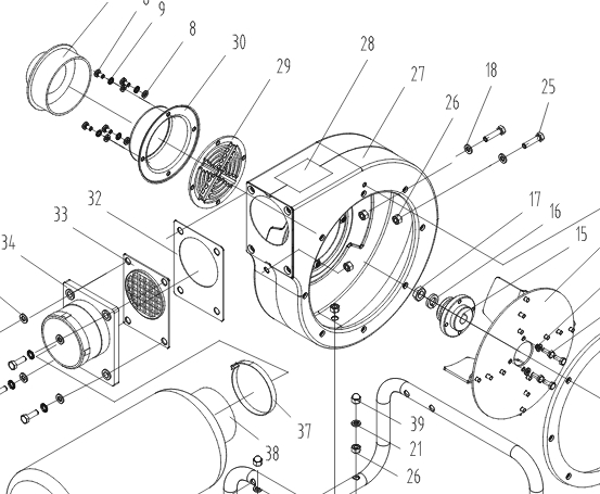

I have the 1hp dust collector and it works well now. I have a larger one and I wanted something smaller for things that only make a little dust, like my band saw. It's flaw was that HF put plastic caps on the input and output with slots in them to let the dust though. They quickly would get plugged up and then it failed to do much of anything. Once removed it works great now. My larger collector isn't too noisy but it does make a lot more noise than the 1hp one. Some tools just require hearing protection but things like my oscillating spindle sander, lathe, and band saw are pretty quiet and they don't make lots of dust (although the lathe does make lots of chips but I don't think any dust collector could catch them) which allows me not wear ear muffs while using these tools.
If the 2hp has the same caps (I'm guessing to prevent someone from sticking their hand into the impeller) I would remove them. Because my planer and jointer both have carbide insert heads and make small chips I've never bothered using the trash can set up like Rick is using. If using a straight blade jointer or planer it could make bigger stuff. I have looked into adding a Dust Deputy but so far haven't bothered. In the end a dust collector is much better than a shop vac.

The parts list for the 2hp dust collector doesn't show the caps I'm talking about clearly so here's an image of the 1hp parts. Parts 29 and 33 are what I'm talking about. They severely restrict the airflow to begin with and allow almost nothing but fine dust to pass through them.
