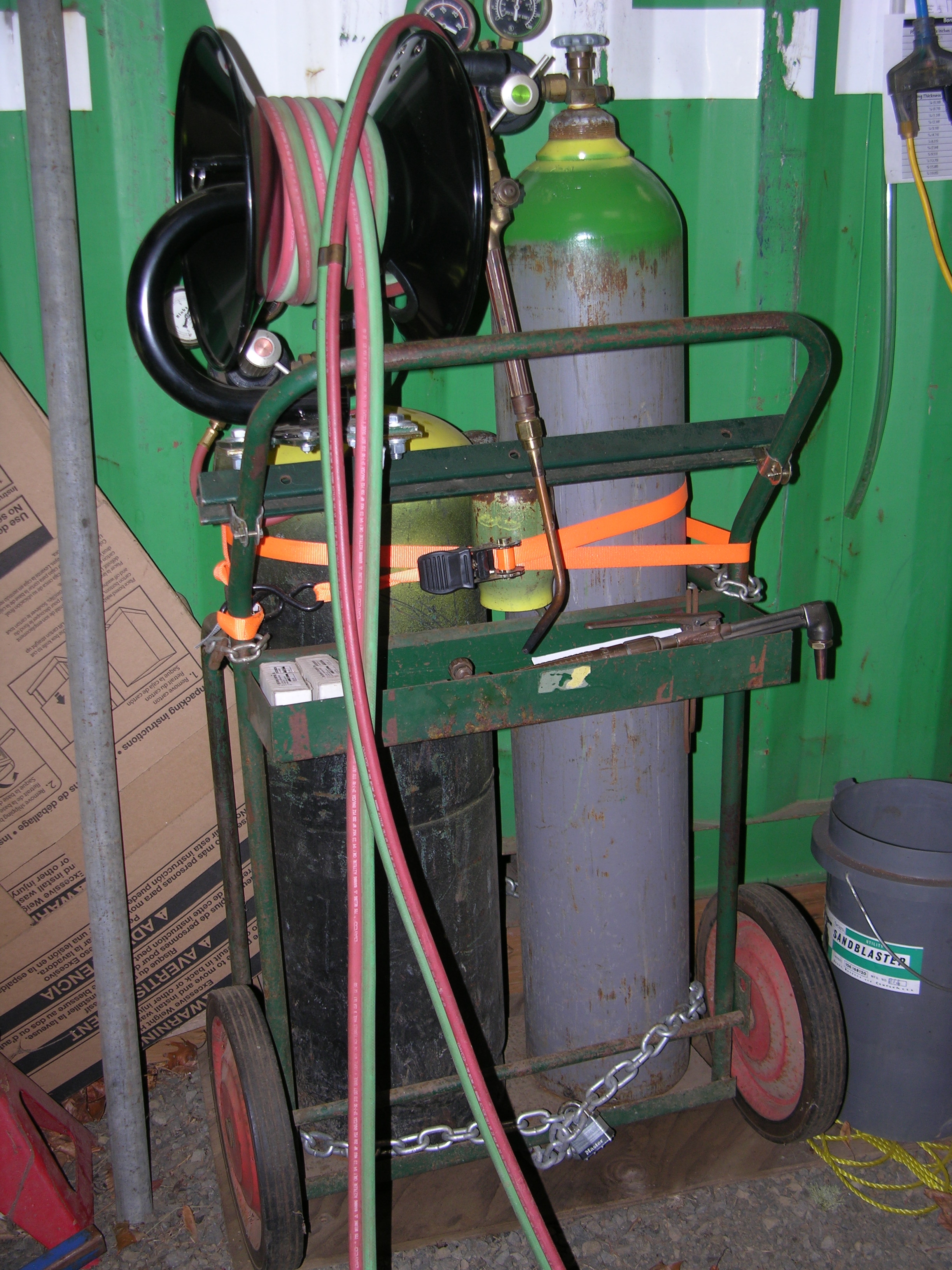

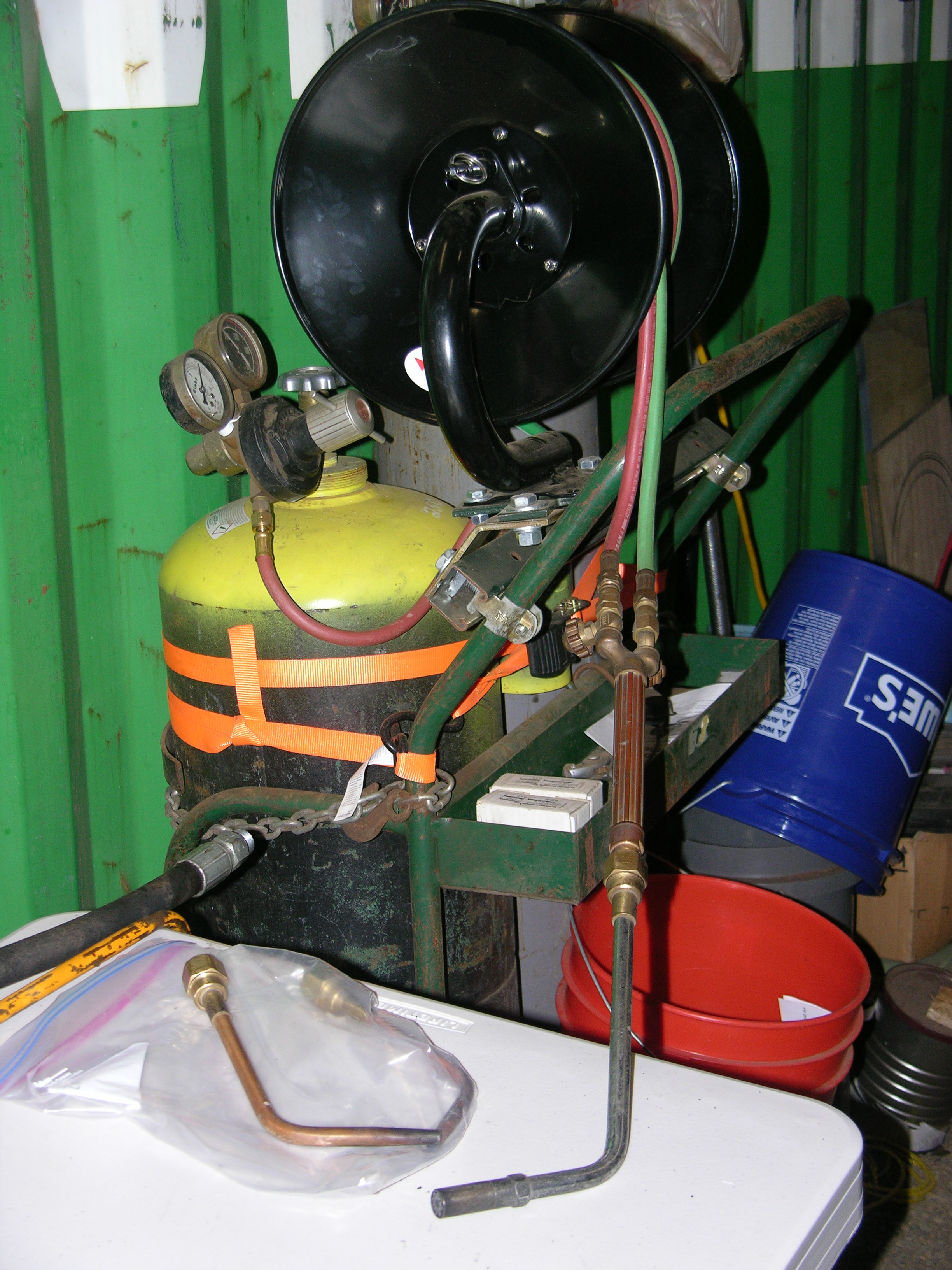

Cougs, before you take this much further, what size acetylene tank do you have? This
AcetyReel.jpg DSCN3267.JPG is mine; that tank is a size 5, the largest single tank you can find - the rosebud in the pic is the SMALLEST one victor offered when I bought it, and it's just BARELY small enough NOT to have too fast a withdrawal rate for safety.
Even then, I don't push it too far, because it's borderline already. (Oh, and before anybody ******* me out about those wimpy straps, all they're there for is to eliminate rattles - if you zoom in, you'll see both a chain AND the heavy "bow tie" retainer that's part of the cart I've had since 1970)
Check out this for more on withdrawal rates -
Fuel your safety knowledge
Do what you like; personally, I'm kind of a "safety ****" on this subject, because someone who THOUGHT they knew it all missed KILLING me by about an INCH when I was 20. The following 55 years (so far) were just a roll of the dice (and an INCREDIBLE GIFT)... Steve

Thanks guys, glad you took it in the way it was intended; I've seen 'WAY too much in my 75 years to believe in the BS statement "what you don't know can't hurt you" -
5030, NOT Harbor Freight, don't think I've ever seen one from them.
Weldcote HRMWOT Manual Hose Reel for 1 ft of Twin Gas Hose - - Amazon.com
BTW, hose (other than a pretty short whip from reel to regulators) is NOT included; for my purposes, I would be VERY unlikely to need more than 50 feet so that's what I bought. Don't see the sense of dumping TWICE as much gas to atmosphere for no good reason...
If you zoom in on those pics, you'll notice several pieces of my "big boy erector set" - a few years ago I fell into a CL deal, somewhere around $2k worth of Unistrut including over 150 pounds of clamps/brackets/bolts, etc; all for $100. Comes in handy for "temporary" stuff (and some NOT so temporary) :D ... Steve
