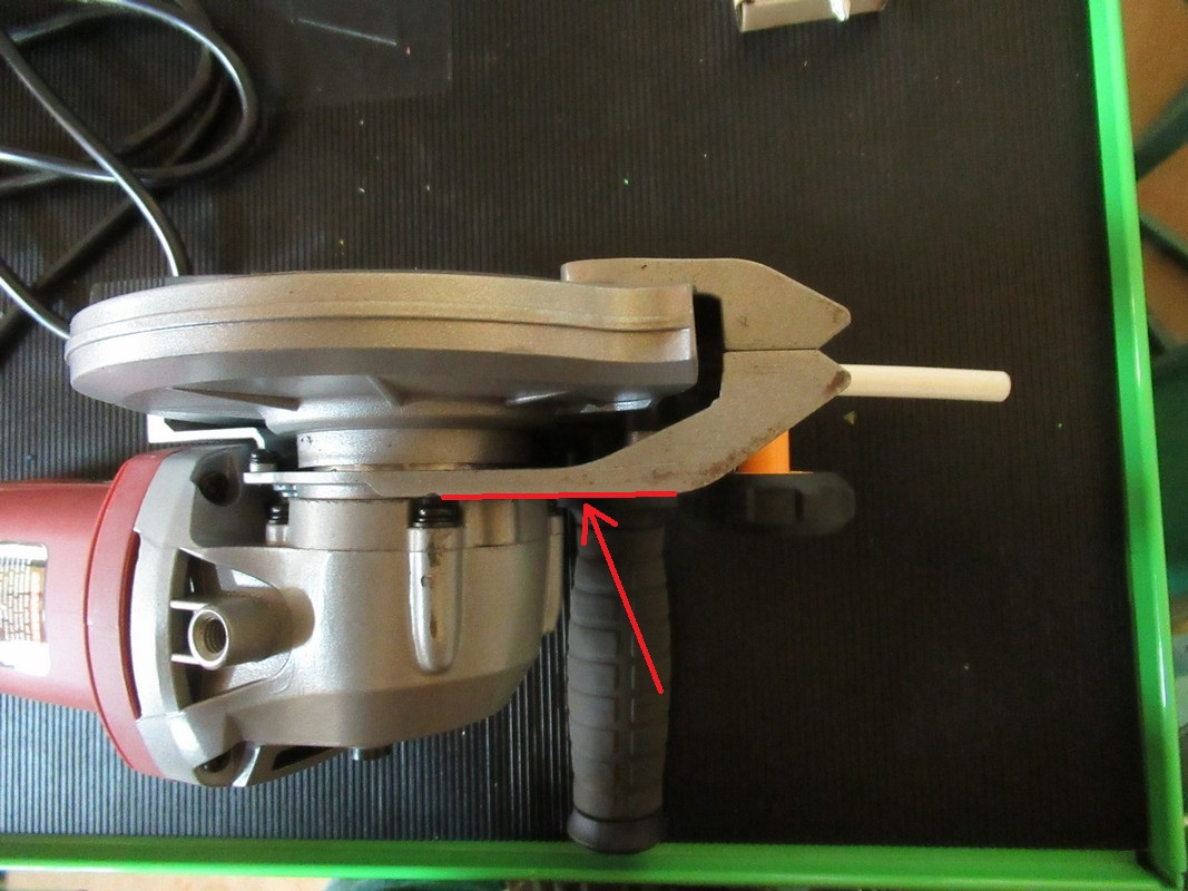

I looked at using a straightedge to guide the saw just like i'd use for my regular circular saw when I cut wood. The double cut does not have a flat edge and the motor interferes with a saw guide. And yes, I know this statement is hard to believe so I'll try to get a picture later today.
   / Harbor Freight Tools that don't suck #14,669
Here's a couple of pictures to help explain the issue with the guide. First the saw is upside down so you're looking at the base plate of the saw. The redline is a straight edge and is normally where the saw would rest against a guide.
In this second image, you're looking at the side of the saw from the motor side (direction of the arrow in the 1st picture). The straight line with the arrow pointing to it is the same edge as in the first picture. However, notice the oval. This is a mounting lug where the two halves are bolted together and is in the same plane as the sole of the saw. Using a guide will only work until it hits the lug. To use a guide you will need to attach something to the bottom of the saw, but the manual says max depth of cut is 3/8". I've not measured how far the blades reach beyond the base plate, but it's not a lot.
Could you use the other side of the base plate for a guide, maybe, but I'd much prefer the guide be longer and nearer the shaft of the saw. I still like the saw and plan on using it more.
