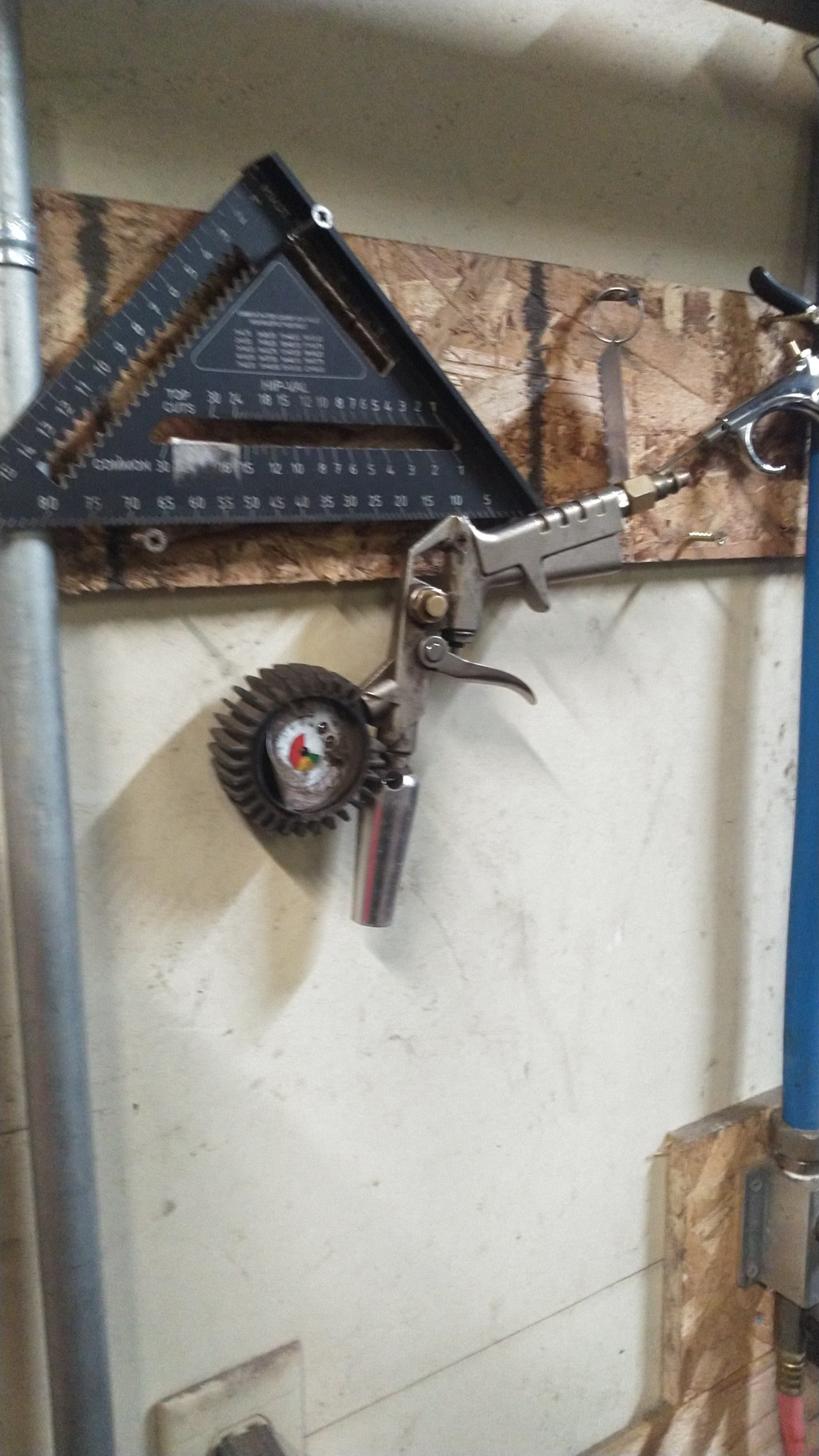

I use an oversized blow gun it disperses the air enough so it doesn't bend the rad fins, works for me.

All well and good at the shop (and I do that as well) but in the field, the handheld Bauer blower works for me. I use it on the square bailer knotter stack as well to remove the chaff build up that causes missed bales. Hay chaff is always an issue when bailing and it would take a heck of a long air hose to get a blow gun in the middle of a hayfield...lol

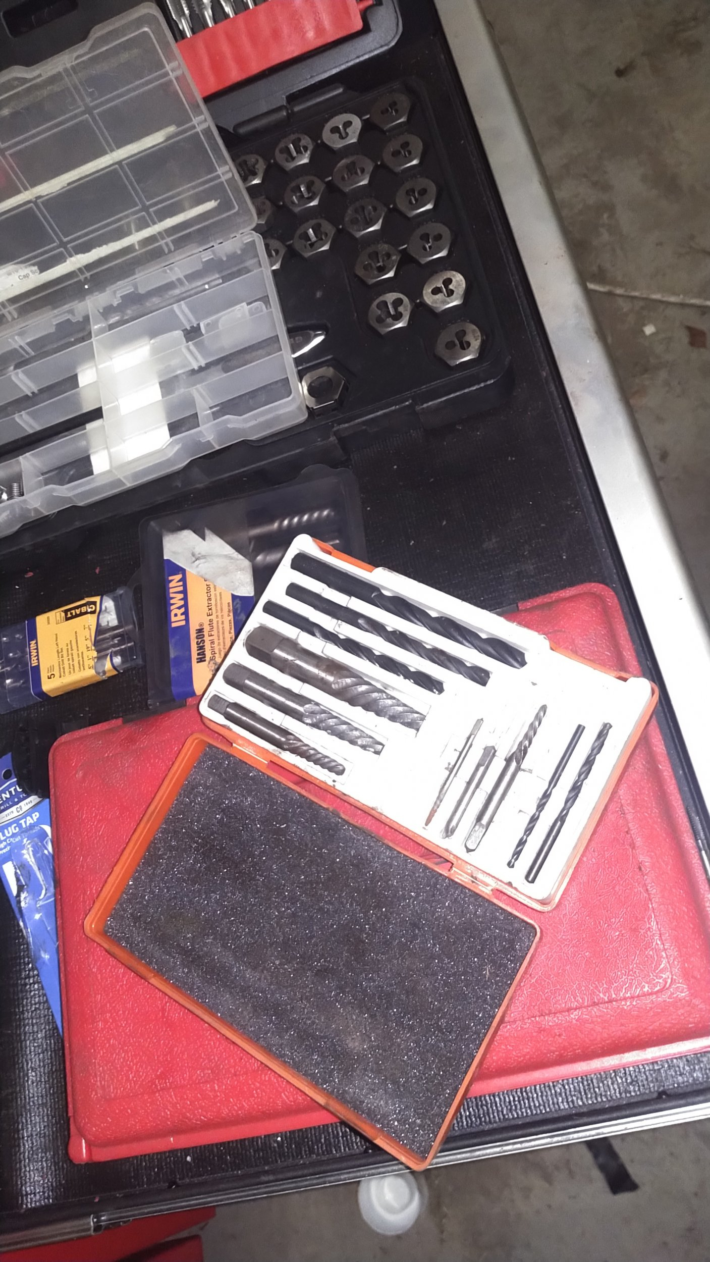

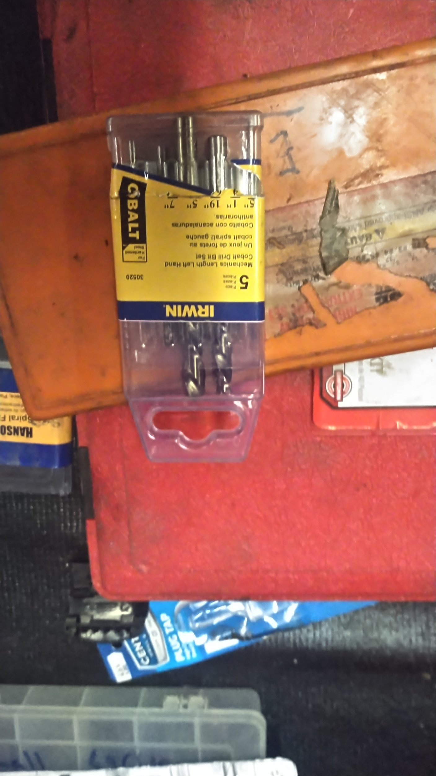

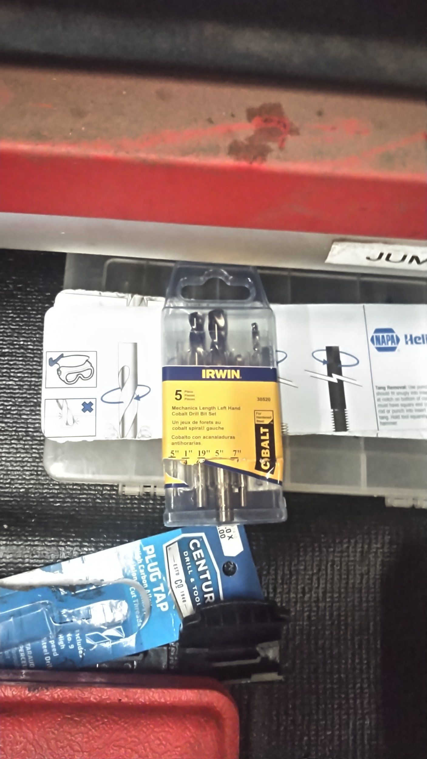

The hf central forge fluted extractors are ok I've had this kit for years, drill bits that came with them are garbage, finally broke a extractor I won't discuss the four letter words and drill bits I destroyed in attempting to extract the extractor. Finally a older more knowledgeable person led me to reverse thread drill bits for extraction purposes. Definitely don't trust hf bits for that.

I have an (expensive) set of Snap On spline drive extractors. I like them a lot. Don't use any HF bits, only Cleveland Twist.
