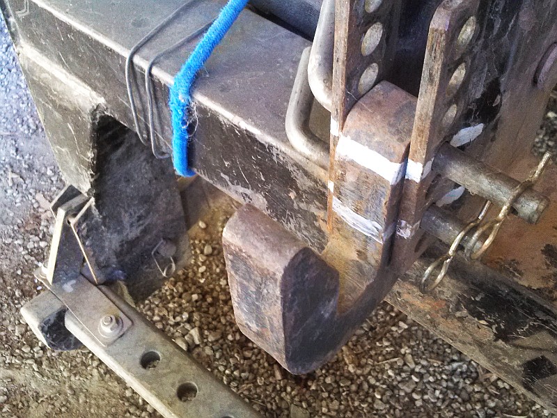

re the HF Quick Hitch:
From your Yanmar-thread post: So a HF store manager said they really are closing out the Quick Hitch after all these years? I bought one of the first ones and it still works like new. Recommended. Everybody, jump on this if you need one, the quality is same as all the store brands that sell at 3x the price.
But also buy the replacement top hook with offset holes so the hook extends our farther from the hitch chassis, if needed for clearance on your implements.
Some stock photos from a search on Amazon for 'quick hitch top hook'. I use clips like the second photo, for quick adjustments.

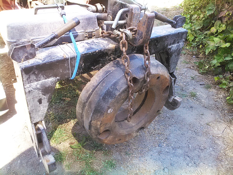

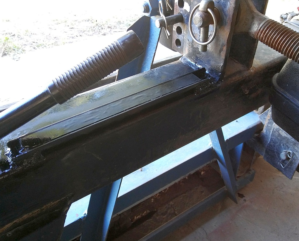

Some QH links:
Post on here showing Speeco's upgrade Top Hook with the offset holes for more clearance.
HF magnet tool bar, cut down and welded on the QH so clips and linch pins don't fall down in the weeds when adjusting the top hook.
Tow bar modified so the trailer ball stays upright. Both ends of the strap are bolted to existing holes.
Temporary rear ballast, when backfilling a trench in a very tight space between barn and fence. I should have also had that towbar on, to get the weight a little farther back and reduce swinging.

Some QH links:
