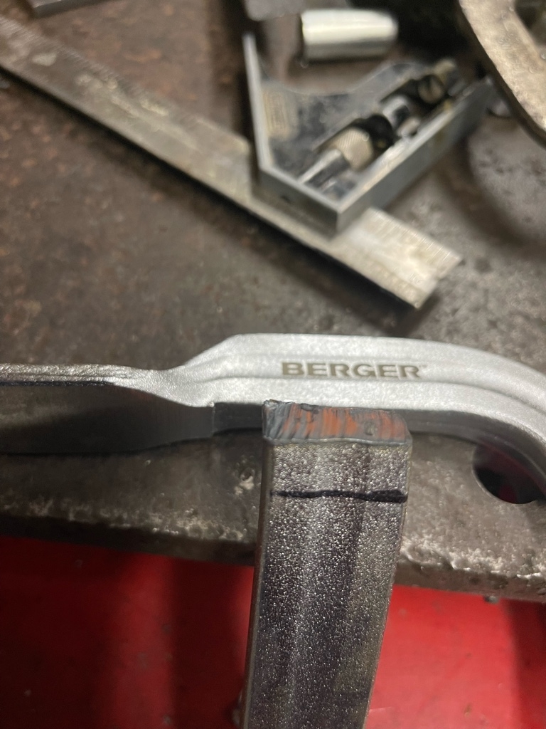

Can any give a review is these HF welding clamps?
I can, I have a few pairs of the F style clamps and they work well but I still prefer the screw type bar clamps over them. The F style clamps tend to deflect quite a bit under tension. Just like their 'C' clamps do. No reefing on either... if I need something REALLY secure, I go to my Wilton C clamps.

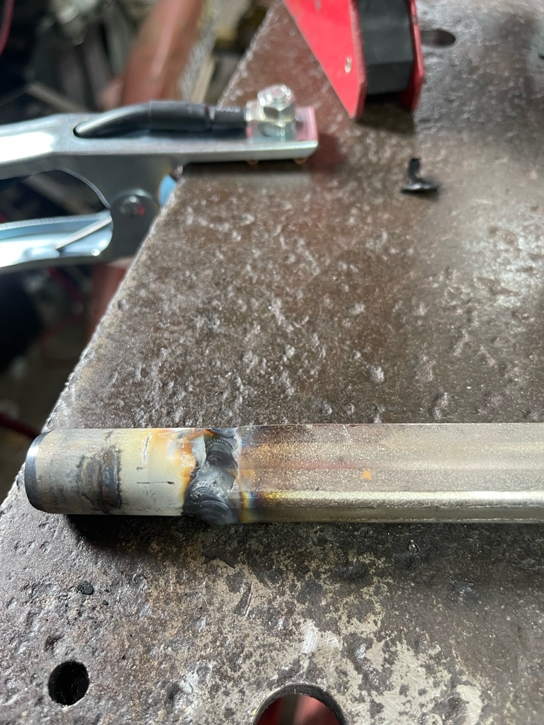

They are not bad for the price. I have a batch of them that I cut off and welded round stock to, so they plug into my welding table.
