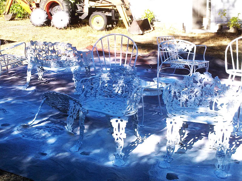

Photo - the last time I painted at a scale larger than a spray can. HF's (then) $10 spray gun, HF 10 gallon compressor, HF regulator/water separator. Rustoleum prime and finish coat. 'Good enough for the girls I go with', to quote an old Carpenter buddy. :)
kimg1753rpaintironfurniture-jpg.477002
Looks good and got the job done well, working on the cheaper end of the scale at that! I love working with almost all of my HF tools. I'm just a homeowner not a contractor and they work well for me!
