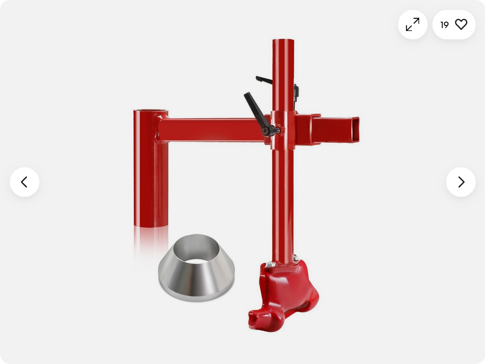

Many years back I picked up the HF manual tire changer. Was not impressed with it since it was a pain to mount any but the lightest weight tires with it. A couple of weeks back while perusing items on Ebay I happened to see an attachment for the changer that gives you a duckhead for easier tire removal and remounting. They go for ~$60-100 and with them it is suggested to pick up a rim clamp.
So I bought it and 4 new 6ply tires (the factory ones were 4 ply) for my Yamaha Quad. This morning with the help of a neighbor I changed out all 4 tires in about 2 hours. The biggest issue I faced was breaking the tire bead (the front tires really did not want to let go). And also the front tires did not want to seat the bead after putting the new on the rims. With the help of a ratchet strap, air, and pushing and pulling and cursing a few times the tire beads finally popped into place. The back tires were much easier and required no special effort.
It helps to watch a few U-tube videos for how to correctly use the duckhead attachment. This attachment makes the HF manual tire changer into a decent garage tool.

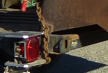

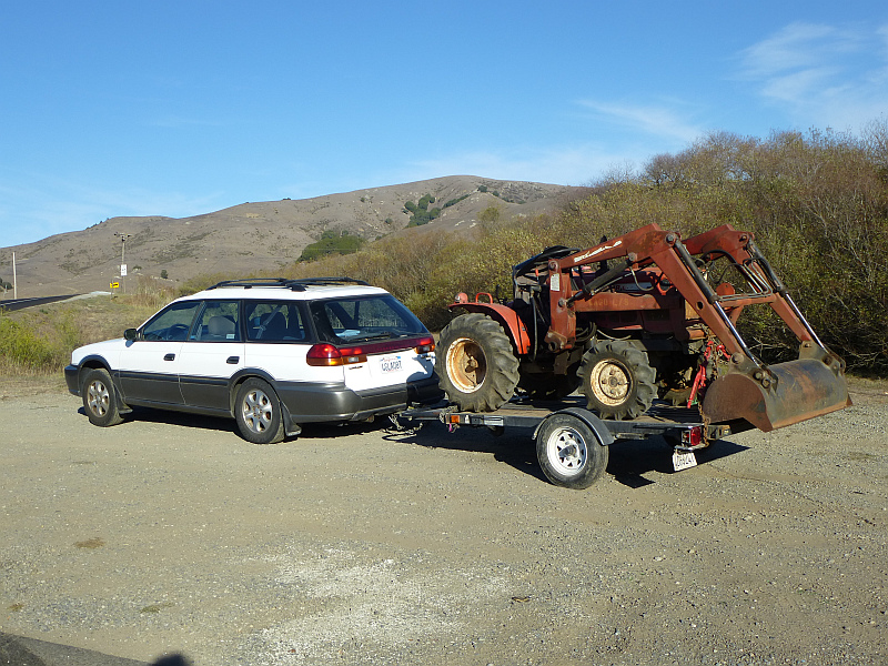

Yes I'll likely need vinyl flooring.
As for mounting the unloader ...

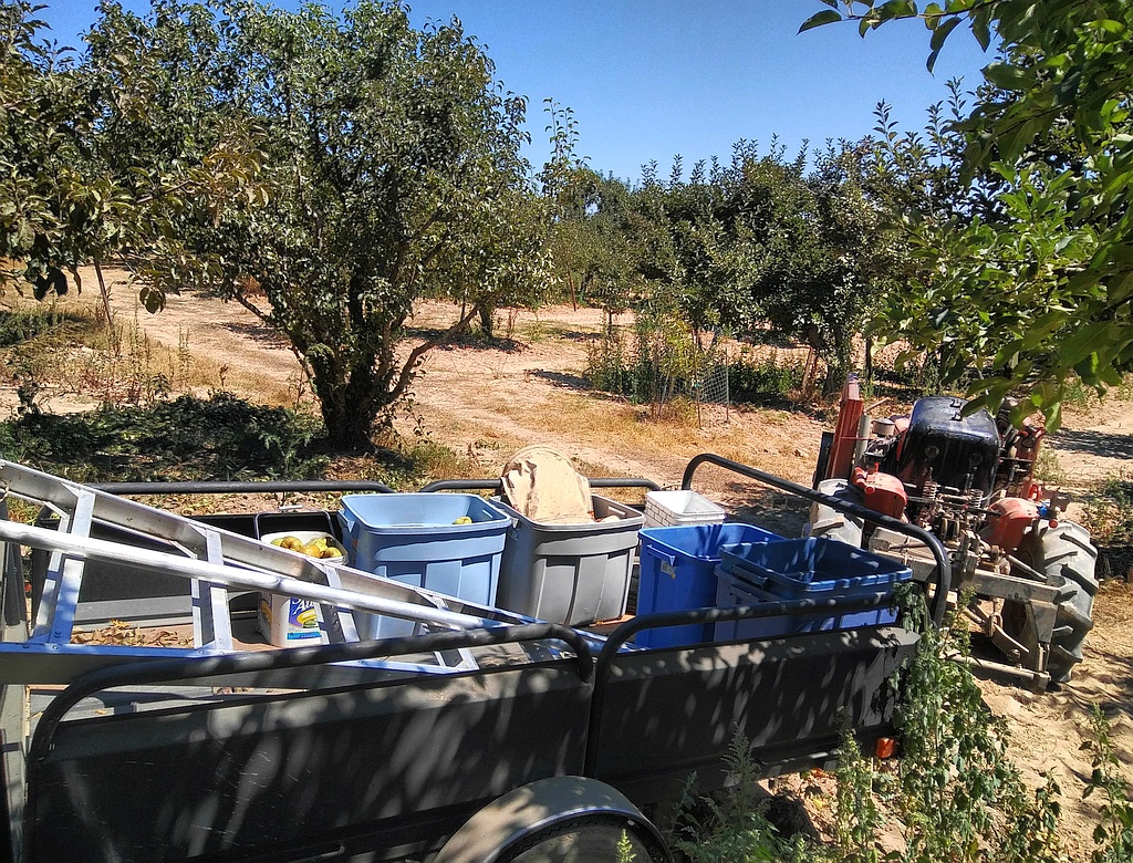

Here's a photo I've posted before, and an enlargement from it. (The trailer's sides and tailgate were removed for that trip). The tailgate has pins at a 45 degree angle that drop into those holes at the back of the frame rails then stick out holes on the the bottom. This means the tailgate can be turned over and set back in flat, like a pickup's dropped tailgate. But this tailgate isn't suitable for the unloader to slide material across. (Third photo - tailgate is same as this front panel).
I can't clamp the unloader to those frame rails in the second photo because I need those holes clear, to receive the tailgate's pins.
The rear crossmember is 1x2 tubing. I could nail a wood block behind it (under the deck) to make the thickness uniform for a clamping surface, and then cut down the unloader narrower. But the straps? And with the unloader installed, the tailgate pins couldn't drop down far enough to engage.
My thinking at the moment is make an additional rear crossmember with pins, duplicating the bottom edge of the tailgate. Bolt the unloader to that. Carry the crossmember/unloader assembly on top of the gravel. (There's 170 inches of fabric, plenty to loop back over the tailgate.) Then for unloading install this crossmember/unloader in place of the tailgate.
When I get back to the ranch Tuesday I can post more photos if I've made any progress!
