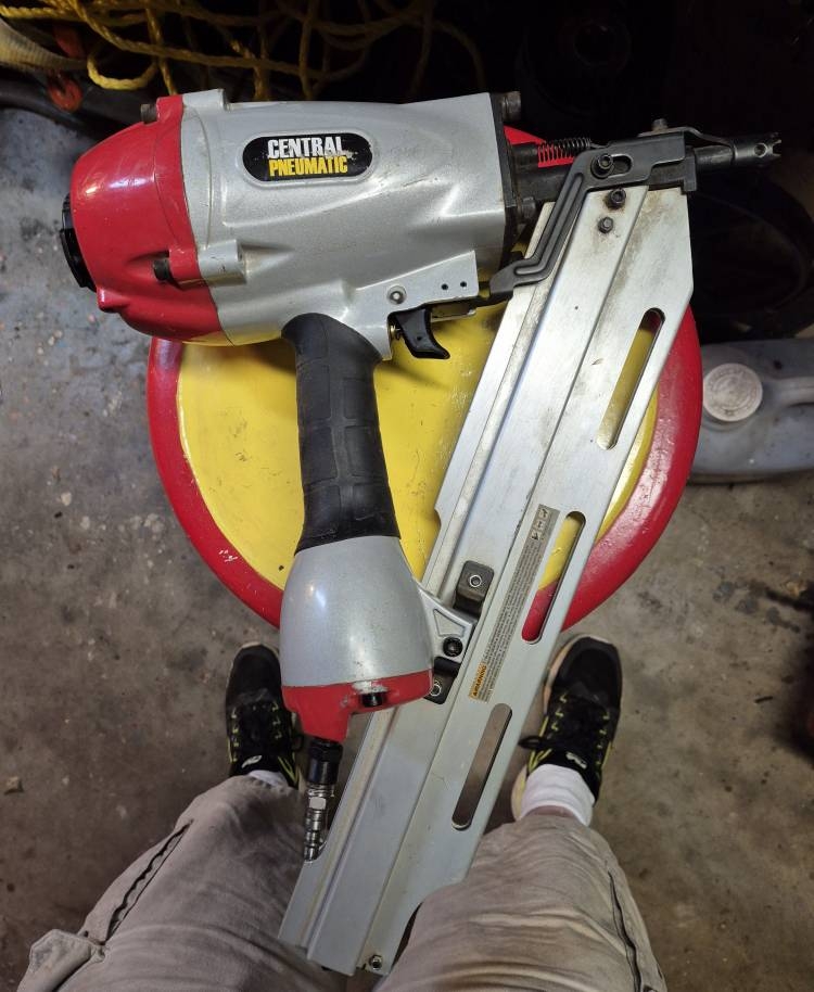

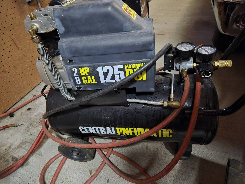

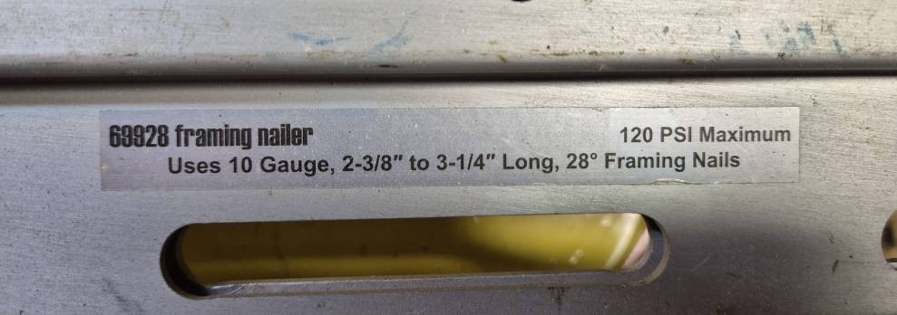

I've had this HF (oil) compressor for many years. I can't remember what I paid but I'm guessing about $150. Then a few years ago I saw they had a 28° framing nailer on clearance. 30 degree nails work fine in it.
My contractor friend & I were building a tack room in the horse stable and both his expensive compressor and nailer quit so I got mine. They both worked great and he was surprised.View attachment 3451393View attachment 3451394View attachment 3451395

I have the exact same one. It has recently taken a crap after about 5 years. It's acting like a start capacitor; but i replaced that and zero difference. I'm likely to replace it with the similar McGraw one, but have considered going oilless?

Is there some sort of unloader on these so it doesn't have to start against the full pressure in the tank?
Alternately - the reason I replaced the overheat cutout (described above) was the compressor would stall when worked hard. Replacing that resumed normal operation. It is a reset button located behind the yellow arrow near the top of the machine, in my photo above. Dunno where it is located on yours.
My unit is the oil-less version. I bought it in about 2004 and only those electrical features have needed attention. After replacing those, it works same as new.

Do you have to press the trigger and depress the head of the the nailer every time you want to put a nail in? Nice it works with 28 and 30 degree angle nails clips, when I built my place ran 2 framing nailers off my old craftsman 26 gal. all day. Kind of looking at a 24 gal porter cable brand compressor mainly for price point can pick one up for over 100 less than a HF one however I'm well aware of you get what you pay for.

My nailer worked both ways, position & trigger or for speed hold trigger and tap & shoot. It has a single or three lever. Not sure why I'd ever drive in three nails at once. Mainly we used it to assemble then went back with deck screws.
