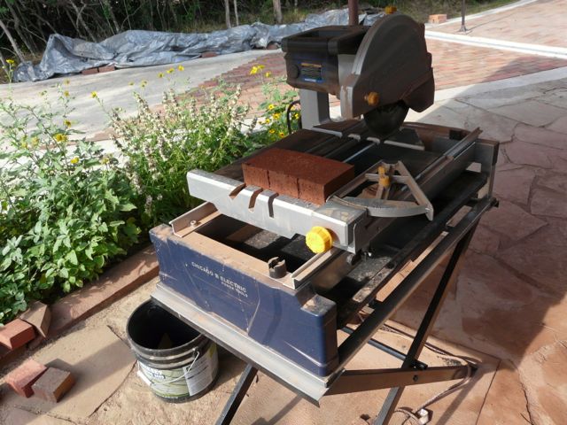

I also bought the new 10" wet brick and tile saw and the continuous rim blade last week to cut 2"x8"x4" solid clay pavers. It is working great so far. with it being on sale and a 20% coupon I got it for $199. I splurged and bought a year warranty with it. I still have 5000 pavers to lay........
One thing I am doing since I'm cutting sticky clay pavers is to put the water pump in a separate 5 gallon bucket and just pour out the tray water after about 15 cuts.
Also I mistakenly got the stand for the older model and it does not fit the newer model saw. I had to cut the protruding pins off the stand and now the saw fits fine. The new stand is on back order till the end of June.
This is a lot easier and cleaner than the 4" cut off saw I was using.:thumbsup:

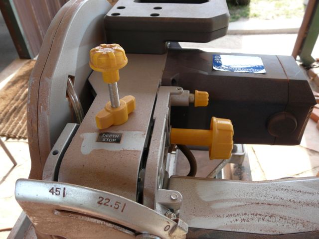

That's the stand I got, might still be on sale for $39. I Don't know how much the new one is but it also has wheels and folds. The new stand is not on the internet site you have to call HF. The item number for the new stand is 69325, which is for the new blue 10" tile and brick saw item number 69275. The new saw is not the one pictured on the HF web site. On the new saw the saw head swivels to 45 and 30 degrees instead of the tile standing at the angle on the block. (The old saw I'm referring to is item number 95385)
However the old stand, item number 46625 ($39), will fit the new saw if you cut off the 4 metal pegs protruding from the top of the stand. You will also have to provide two bolts that screw the stand to the bottom of the saw. The threaded holes in the saw line up with the holes on the top bars of the stand but there are no slots for the pegs on the new saw. (The new stand is the one pictured on the new saw box according to the picture HF tech sent me.)
It's 45 and 22.5 angle cut see photo
also photo of the new stand coming by the end of June.
