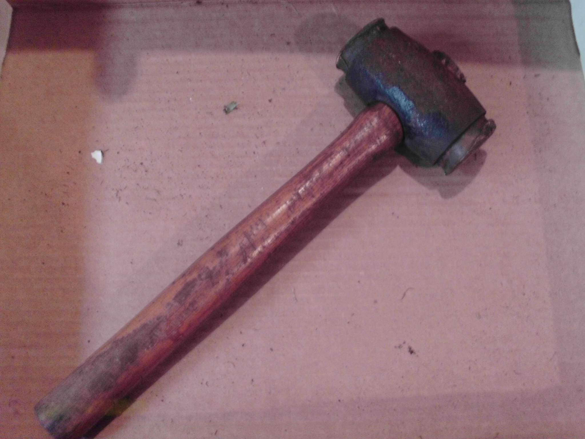

Now you have ask yourself what could POSSIBLY go wrong with buying hammer from HF?
Well let me tell you :D
I bought this 2lb double sided brass faced hammer what piece of work that was. The first time I tried use it the head came flying off. It was just secured with just a wooden wedge (a design that which a lot of tools once used (like back in the stone age lol) The handle fit was so loose in the hole in the cast iron head it wouldn't hold tight so I used a silicone adhesive and double wedged it. Its had a pretty good workout since then and usually the first persuader I grab most times so I guess NOW it qualifies as a HF tool that doesn't suck too.
I've had more expensive hammers than HF with loose heads, but ya.. I drip in some epoxy and let it soak in and harden. No more problem. Ever :)
