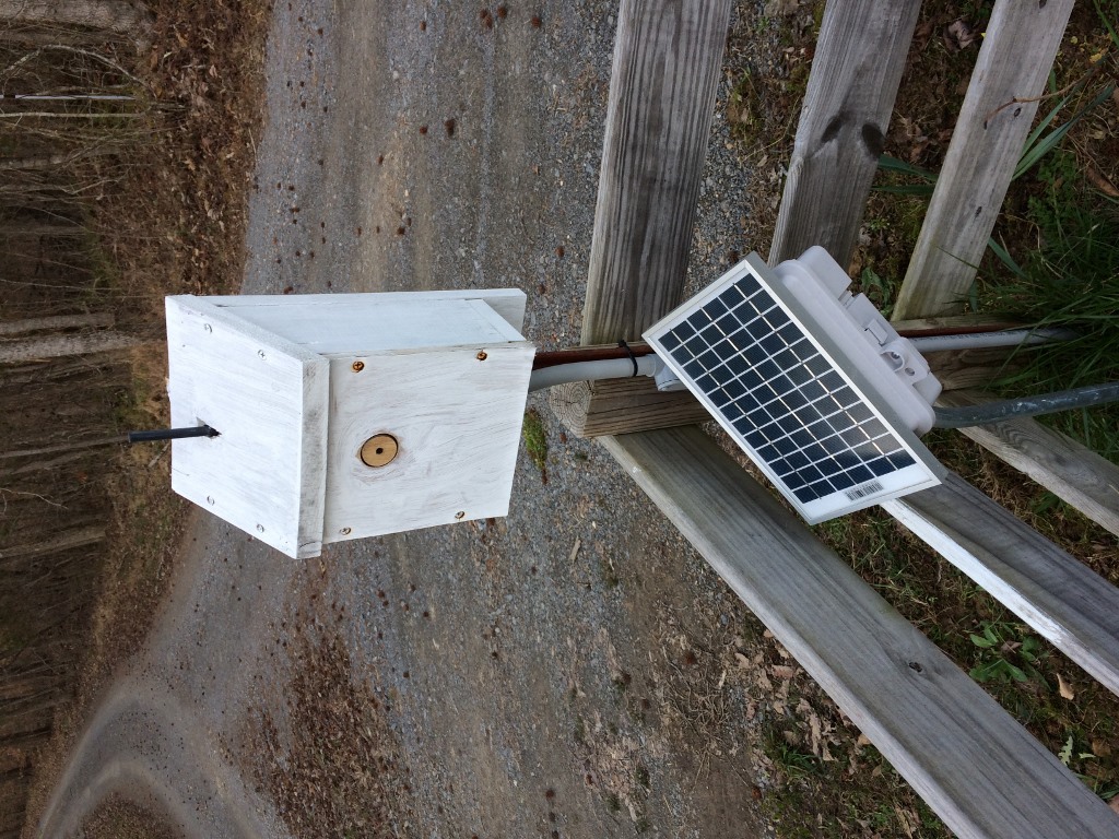

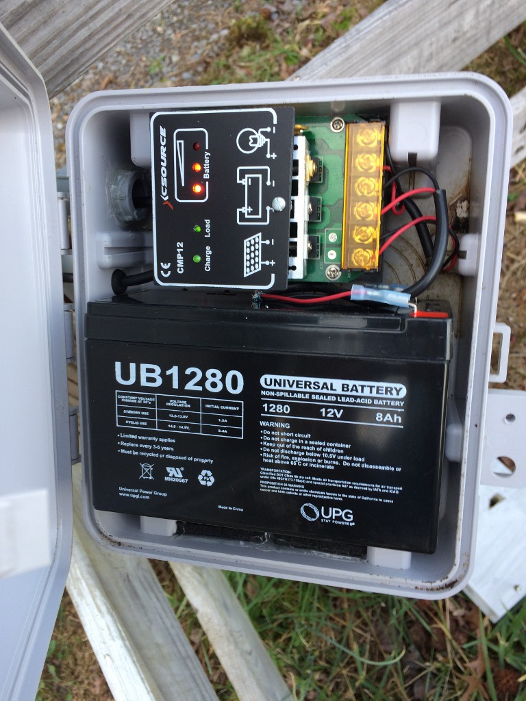

Drew, I built one that I think is what you'd like, quite inexpensively from some Amazon parts - a universal battery, a decent solar panel, a cheap charge controller and a nice sealed box. Maybe $60-$75 in the whole thing. I use mine to power a driveway alarm. You can select whatever size/capacity suits your need. Mine is 5w/8aH, mainly because that was the biggest battery that would fit in the box, and the panel was a nice size to mount on the box. It's been working perfectly for over 3 years now. I was quite surprised to find that almost no one is making "pre-assembled" little solar charging setups like this.

It looks like some of this stuff is rising in price and becoming less available. I wonder why?

thanks, nice set up. The charge controller isn't waterproof for sure, so it needs a watertight compartment.
