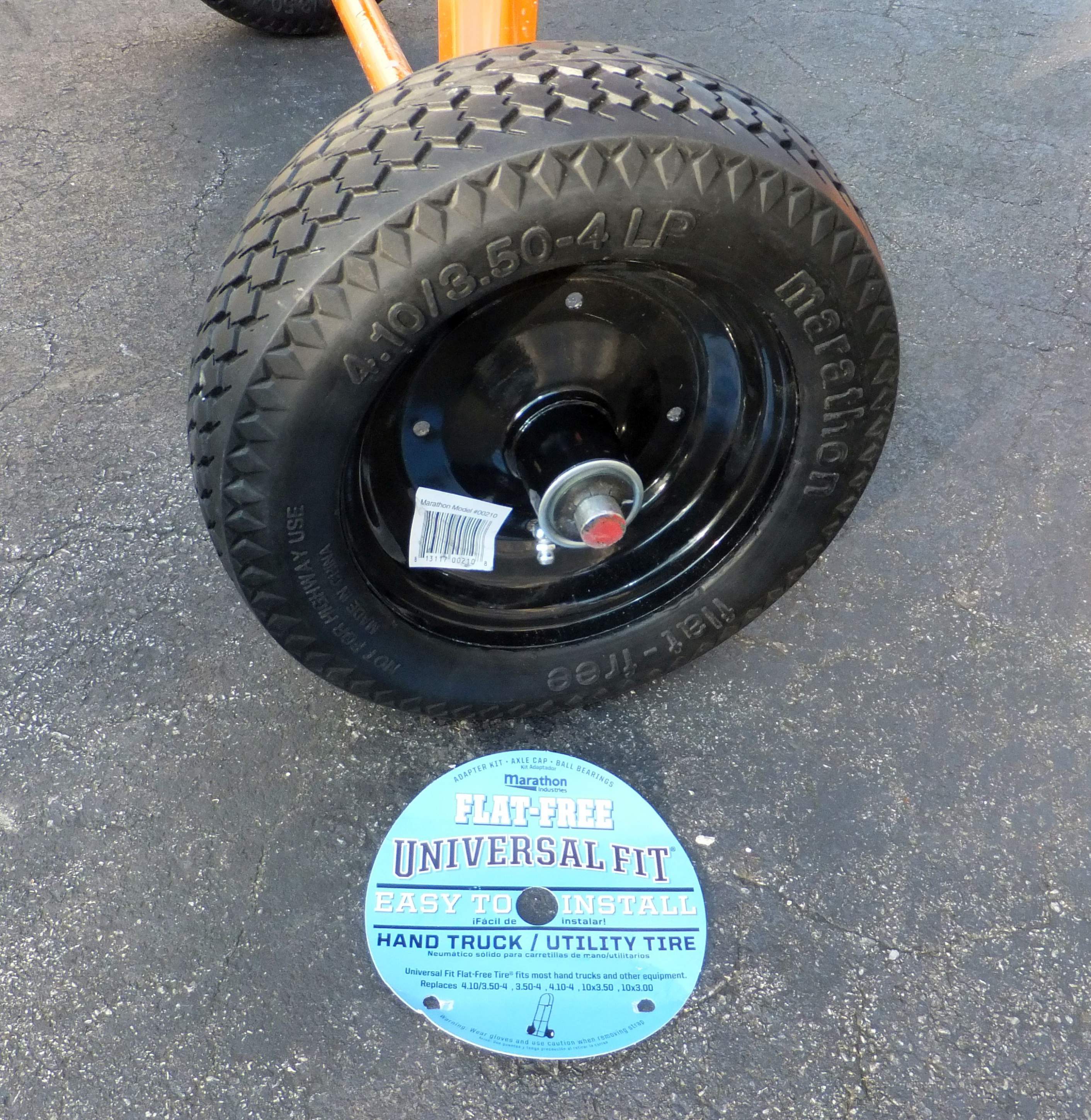

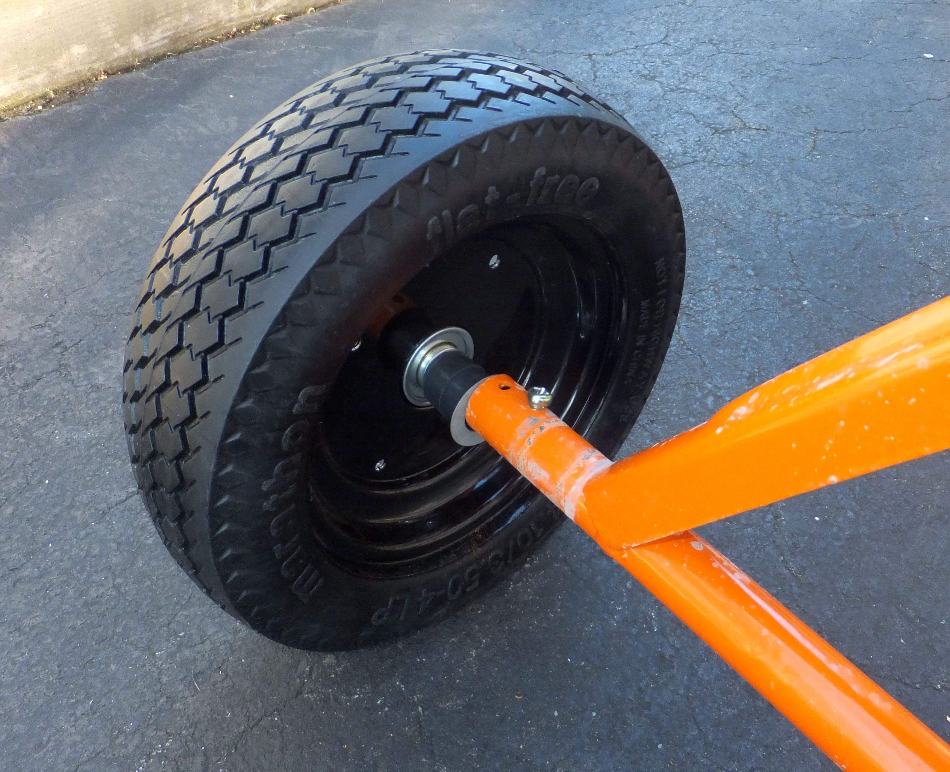

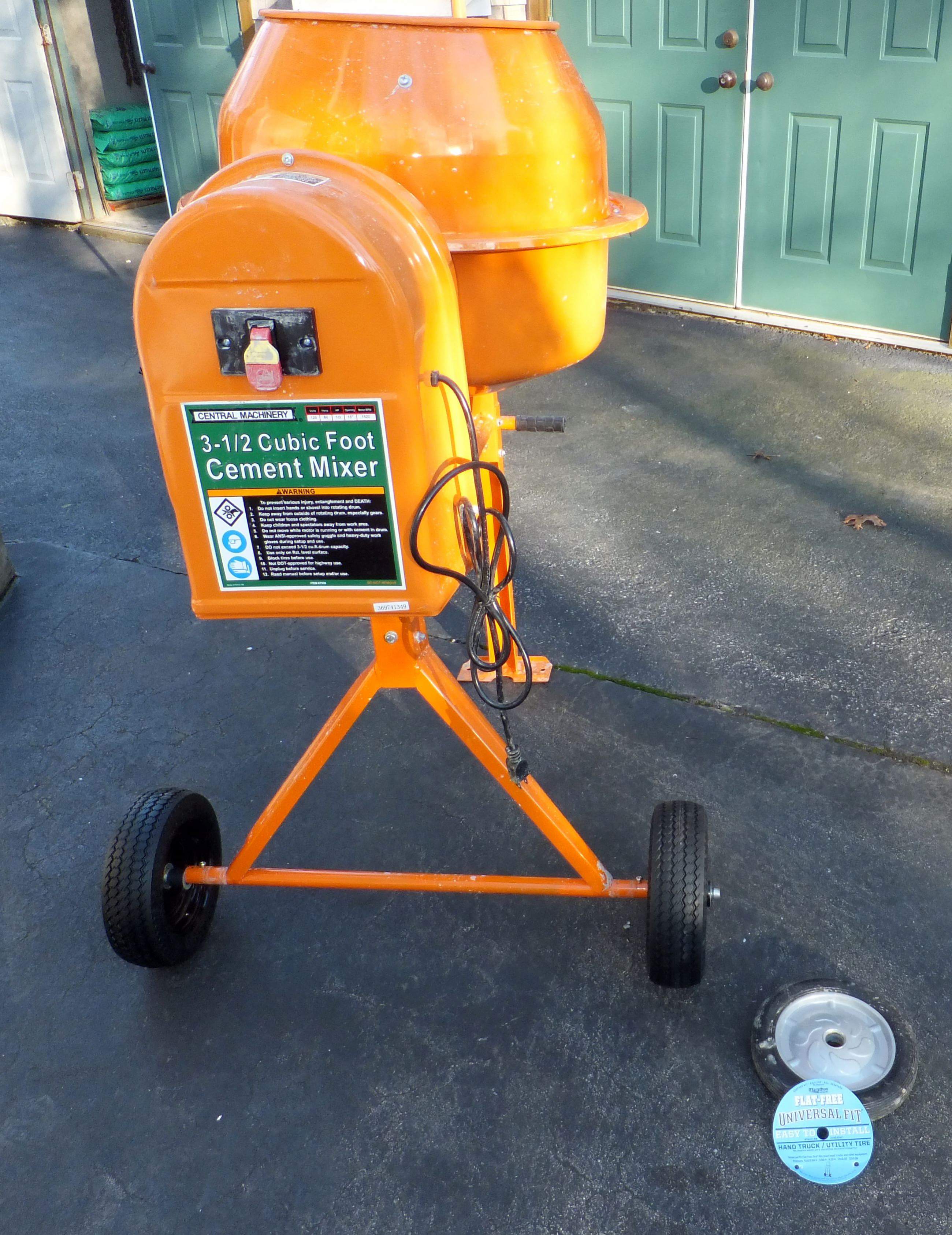

I was wondering if anybody has had luck replacing the wheels on the Harbor Freight 3.5cf concrete mixer. I like this tool a lot, it's saved me a ton of work, but the wheels are too small and definitely too narrow. The problem is the axle on the unit is 1" and I can't find wheels anywhere that would fit it. Ideas?
The picture I see (at: Cement Mixer - 3-1/2 Cubic Ft. Cement Mixer ) shows a hollow shaft for the axle. I would get a steel shaft that fits inside (5/8" if it would fit) and mount the wheels to that. If you need to narrow it up, cut the hollow shaft off at the side of the leg.
If yours has a solid shaft, I would mount a new 5/8" axle underneath the current one

If it was me and you plan on keeping the mixer I would get a set of airless wheel barrel wheels and replace the bearings with bushings. It should last forever and will have no issues handling the weight of the cement. You might need to lengthen the leg to make it sit level.

Nice. Did you get that from the Fall River store? I haven't seen one there.
In fact, I did! Back in the spring. They are often out of them, and won't sell the floor model. After putting mine together with the near-useless instructions I can see why, LOL! But the manager worked with me and held one for a few hours on the day they came in. He also let me use a coupon after the date, since they were out, so I got it for $189 I think, a great deal. Well worth it. The cheaper one is a toy, this one is decent.
