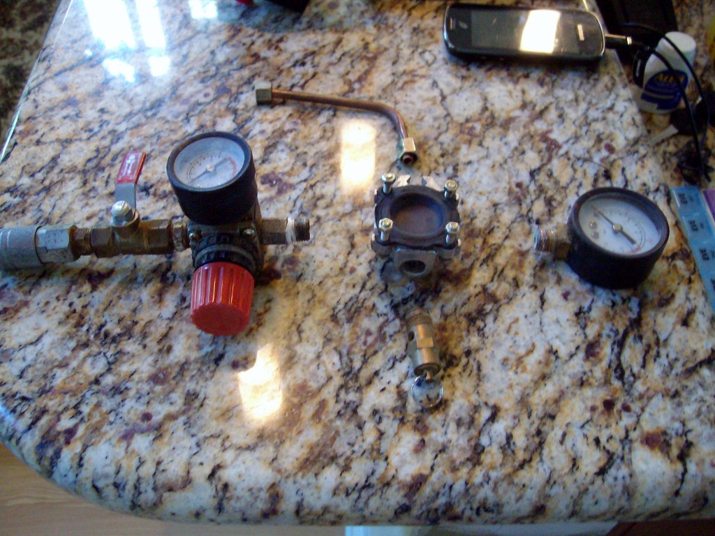

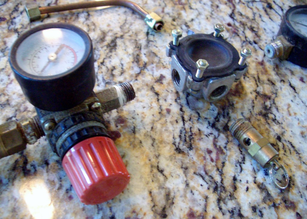

PhysAssist, Mine is all disassembled now waiting for its new switch, but here's how it was together. Yes, it is the oil-filled model. IIRC, where my original broke was also at the fitting between the pressure switch and the tool pressure regulator. This OEM fitting appears to be steel and not brass. I bet that a brass one would last much better. It appears to be a regular 1/4" NPT nipple about 1" long. At least that is what the relief valve is stamped and the threads seem identical; starting threads mic at 0.502". You could probably remove a broken stub with a standard pipe "extractor" type of easy-out. If all else fails, you can replace the entire pressure switch like I'm doing for <$10!

Hi Jay,
Sorry it took me so long to get back here, I've had a long stretch at work.
Thanks for the help,
Thomas
