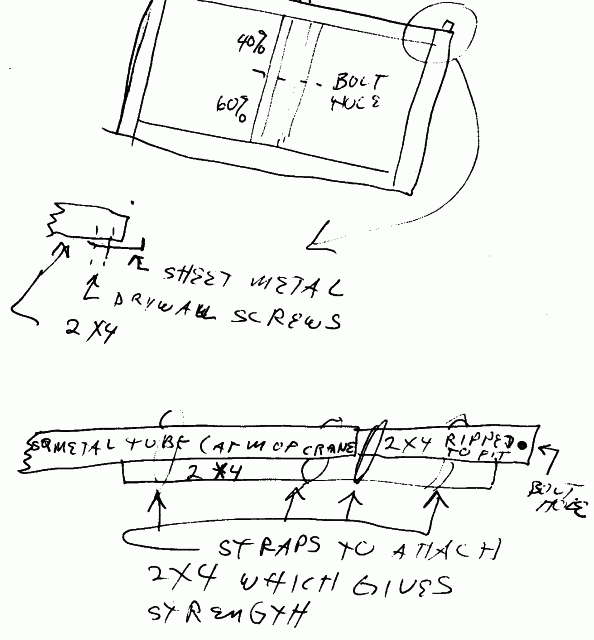

I took the hook off the end of mine, ripped a 2x4 to size and shoved it down the square tube and strapped another 2x4 under the tube, bridging, with significant overlap, between the square tube and the 2x4 sticking out of the end of it. I then attached a rectangular 2x4 (picture frame looking thingy) to the end of the protruding 2x4. I put a pair of cross braces on the 2x4 "picture frame" separated by the thickness of the protruding 2x4. I put a bolt through the two braces to pin it to the protruding 2x4 and allow the picture frame to pivot. The pivot point is off center so it tends to rotate back toward the operator at the rear of the machine. I attached some scrap sheet metal fingers to the far side of the picture frame (picture frame is about 3x7 feet.)

Pat, I have tried to get my head around that description, but I just can't get a visual. It's probably not your description, it is my dense head. Could you possibly provide a drawing or pic? Thanks.

Ah, yup. Years ago I laminated two layers of 3/4 plywood together with glue and screws. I drilled pairs of holes at one end and added rope handles. I made 4 each of them 2x4 ft and used them to drive across fine sand and such where my 4x4 pickup couldn't otherwise make it down in Baja where getting stuck was way beyond inconvenience toward life threatening. They needn't have been so HD but I used them also on a motorhome.
I reread it and have no clue what could possibly be more useless as a description.
Thanks for the idea on the valve mod for the cylinder.
Hopefully the attached sketch will help.
In the sketch you see a rectangular frame with a pair of center braces. There is a hole for a bolt through those braces. The spacing between the dual braces is a friction fit for a 2x4 (about 1 1/2 inches.) The end of extension board sticking out of the crane's square tube has a hole in it where it is pinned by the bolt mentioned above.
The 60/40 balance is a guess. I wanted the material to not tilt the platform forward and fall off. It worked very well and when lifted until it contacted the ceiling joists I installed it pivoted to match the slope of the ceiling (about 2-3 in 12.) It would have worked just fine for dry wall but I used fiber cement for fire resistance as the space is a metal working shop with grinding and welding and some day maybe a small forge.
I'm not an artist (surprise surprise) so don't be bashful ask anything about the Rube Goldberg monstrosity and I will try to explain it.
