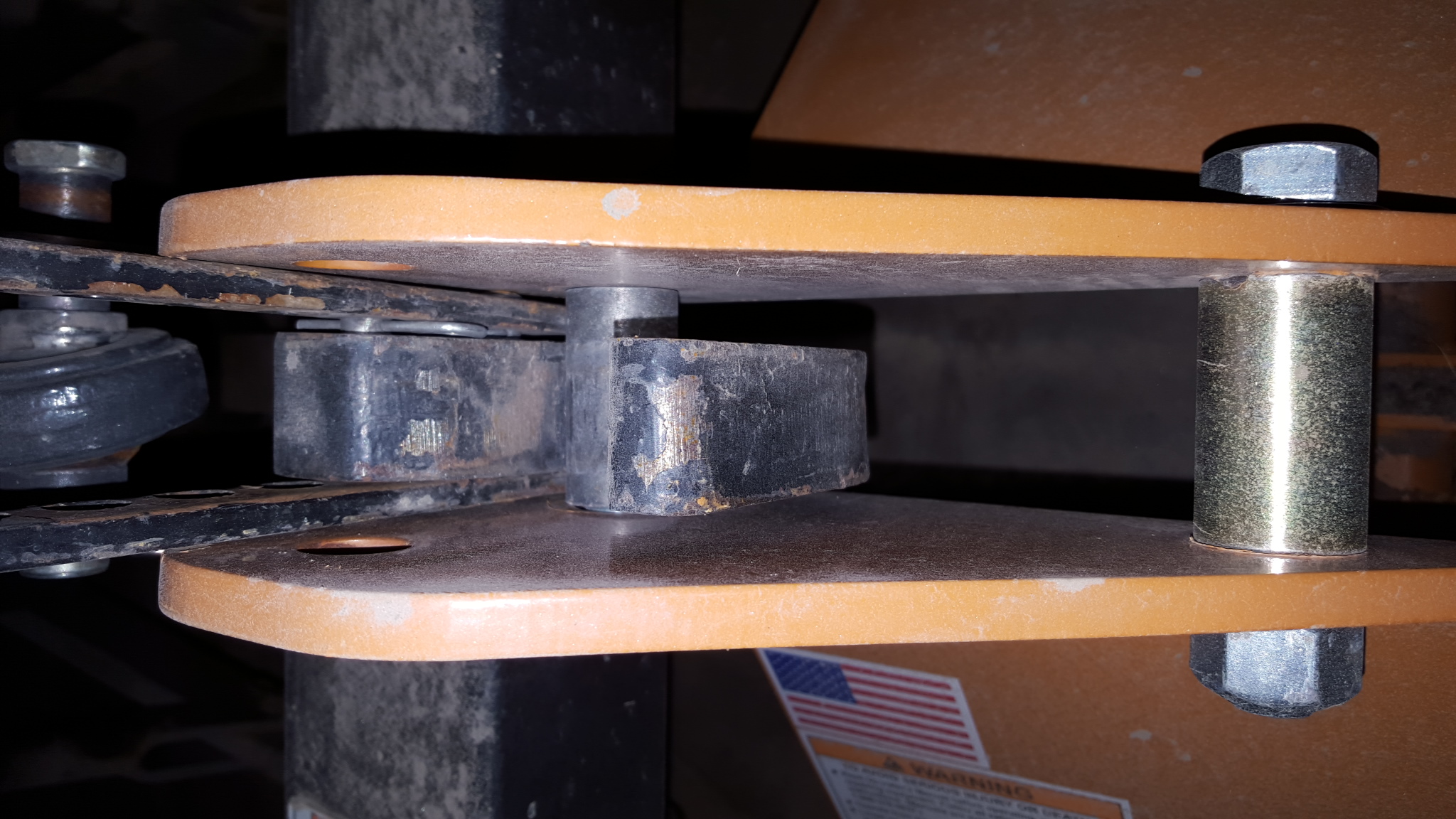

I have two, and they are just fine, especially with a 20% coupon that brings them down to $80 when they're on sale. ;) The oldest one is 8 - 10 yrs old, IIRC, and the lower hooks are too small for the very handy QH bushings that Northern Equipment, TSC and others sell: NorTrac Quick-Hitch Bushing Set Fits Category 1 Hitches | 3-Point Hitch Adapters| Northern Tool + Equipment HF's vendor has since redesigned them, though, so their newer Cat. 1 QHs work great with them.
Depending upon the implements you use, you may need to modify the way the QH's top hook is retained in it's bracket. It comes with a through bolt, and the bolt head and nut protruding from either side of the bracket may bind on some implements. Easy fix is to cut the head off the bolt and trim the shank so that it is flush with the outer walls of the bracket. Bore a hole in the shank for a small hitch pin to between the side of the hook and the inner wall of the bracket. See pic below. I got this mod from another TBN member, Bullitt94, and it's worked perfectly. :thumbsup:
