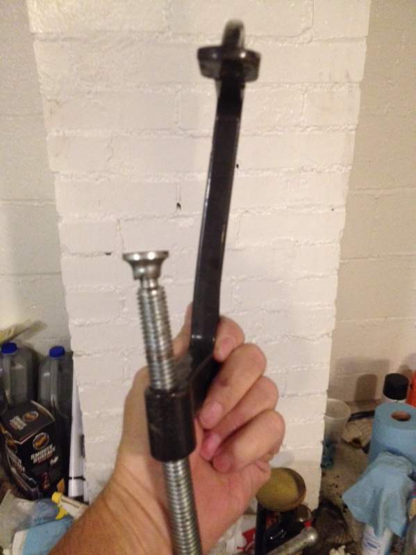

Here's one that kinda Does Suck. The big heavy duty C clamp. image-1892860722.jpg
Ps.. I'm never been big on extended warranties , but if you get any electric drills there, might not be a bad idea. Completely fried s big hammer drill in one day. In there defense it was worked Really Hard, and get the job done just before failure. It was being used with a section of chain link corner post with teeth cut into one end. That was mounted inside to a 4" hole saw. Used the set up to drill through 20" thick sandstone to run drain pipe.
