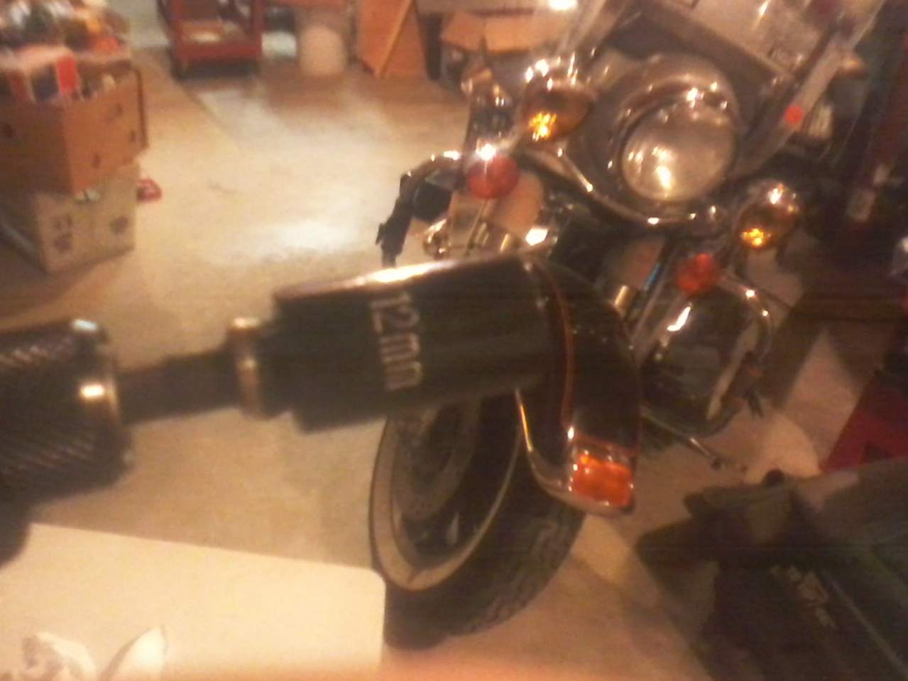

I like that paint idea. Makes it easy on old eyes :D
As Newbury pointed out (post #5174) deep sockets of the same sizing can have different depths depending on brand.
I have deep well impact sockets consisting of several different names and a quick measure shows that the both the 1/2 and 3/8 inch sockets with an older Klutch 59 pc set (no printed markings) from Northern all have a 2 inch broach depth. And so does my 1/2 Pittsburgh metric set from HF. But the metric 3/8 drive deep set I have a Cal-Hawk, are only 1 1/4 inch deep.
All the larger 1/2 drive I have 30 to 38mm and 1 5/16 or more are 3 inch depth. All are the MIT brand sockets.
Real Tool also points out socket differences in this video.
I notice the currently listed Northern set is advertised as being Chrome Molybdenum steel but the one I have is only Chrome Moly on the larger sizes of 1 1/16- 1 1/4 and the 30 and 32 MM. All the rest are stamped CrV.

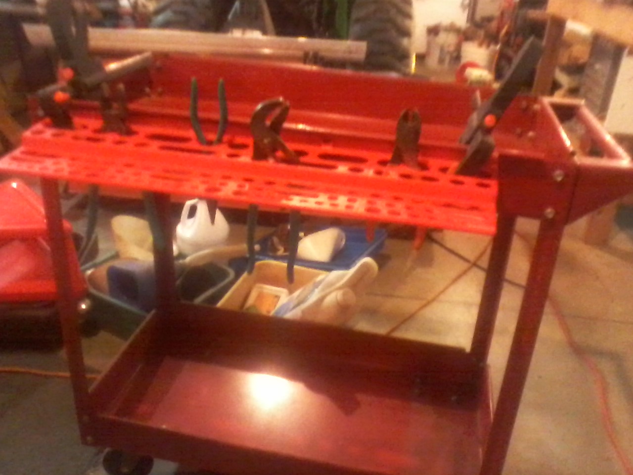

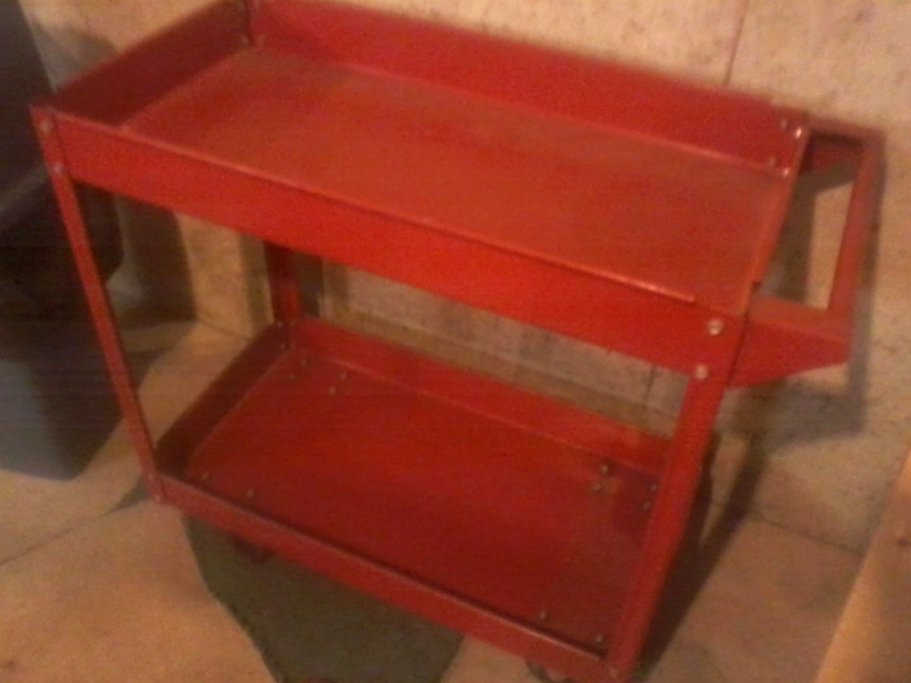

I've been cleaning and organizing a lot of my tools and other stuff in the garage after a very long season and dang...I just discovered another HF find. :eek:

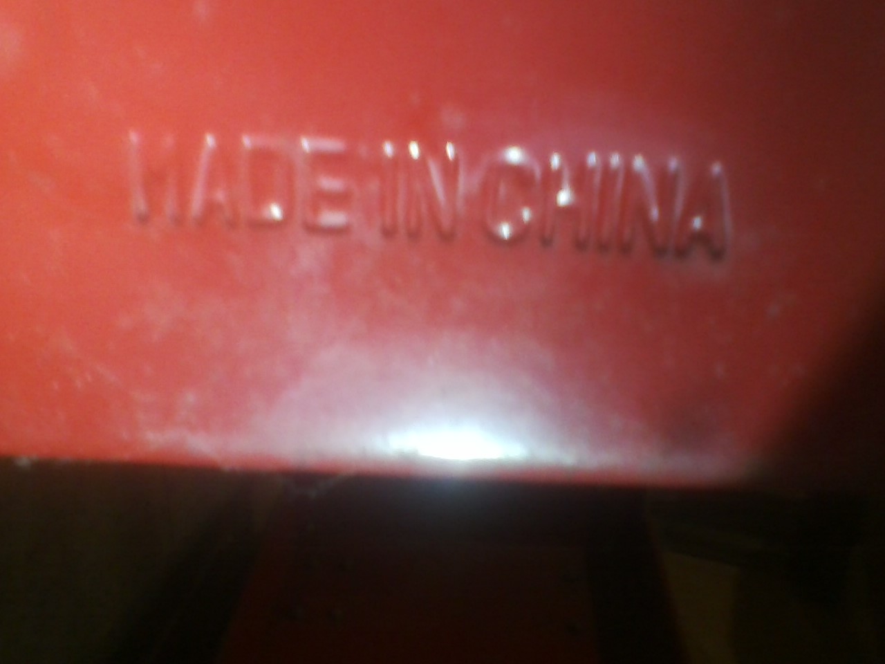

At first I didn't know if it was HF has been so long...of course it has the stamp
That's pretty much a dead giveaway :laughing:
And quick look at their site it is still there online today.
Steel Service Cart - 16" x 30"
Can't recall just what I paid.
Some assembly required as they say but no major modifications that I can remember. :D
Overall its light weight, and not very big. (the handle design is a pretty cheap setup though) but it doesn't suck IMO
I've been happy with it.
I also had some tool organizer rack thing hanging around I may have just found a use for too. :cool2:

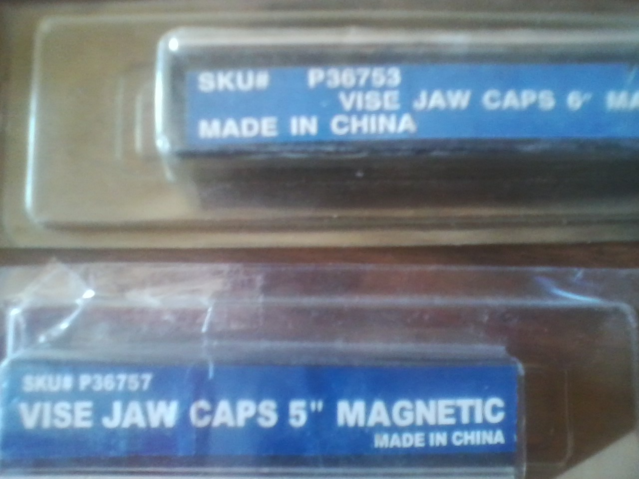

Well some more garage work today turned up two packages of these aluminum soft faced magnetic vice clamps in a tool box drawer of machining tools and associated supplies
I swear they came from Freight does the packaging look like their stuff to anyone else? They have SKU part #'s of P36757 and P36753 respectively. Nothing like them on web site today I can see, The offered much more stuff years ago. I must have gotten the 5" for that junk vice I returned. My Yost from the old CT Farm and Family store takes the 6 inch and I have a set out on the bench already.

That reminded me that I had a pair of HF magnetic vise jaws. The first use crumbled the ceramic magnets and they fell out. The holes in the AL jaws were shallower than the magnet thickness, so the magnets took the full clamping force.
