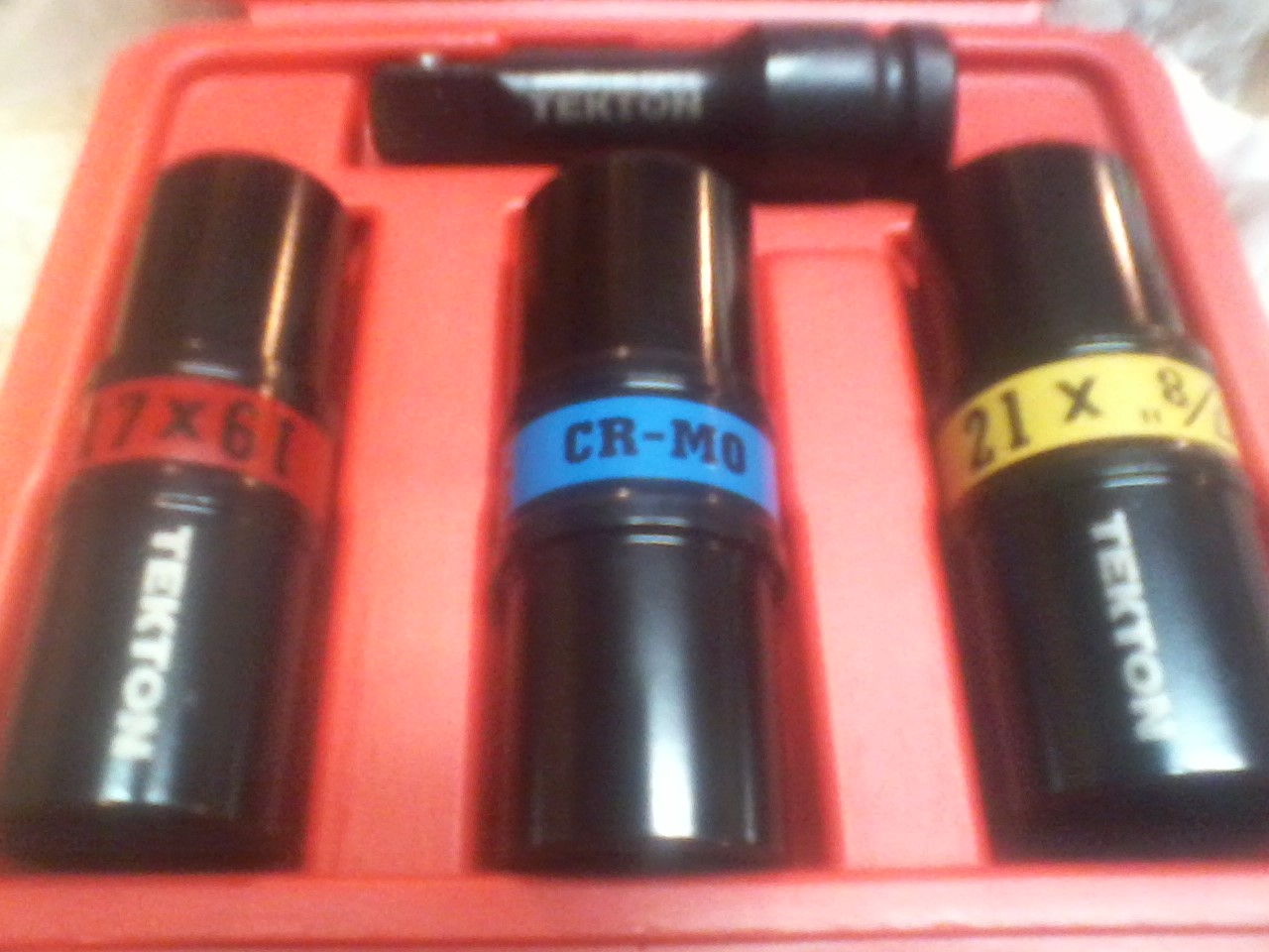

So subject change here...since I do sell Tekton tools too, I got a set of these to toss in the Craftsman tool bag I carry my Milwaukee 2763 impact wrench (how sacrilegious hey :D) to replace some similar chromed ones I was using that came from some set I picked up somewhere with an extendable handle. Not a good thing to do use chromed plated sockets like that.
So does anyone have the Frieght Flip sockets? It is only a 2 socket set I see online. 62491

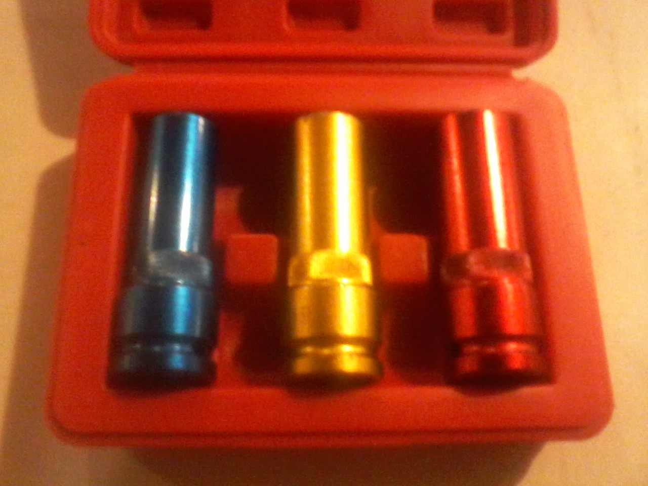

I also have a 3pc set of the colored freight metric lug sockets with plastic sleeves.
Look nice hey ;)
<img src="http://www.tractorbynet.com/forums/files/parts-repairs/450972-harbor-freight-tools-dont-suck-lug-jpg"/>
The sleeves are long gone did not fit most wheels anyway. Sokets have took some abuse too. All freight sells now is a 7 pc or 11 pc heavy duty set I see.
Search results for: 'lug nut'
How about those torque sticks anyone buy them??? A local tire shop uses them I have seen
I have the flip sockets. They are good so far, just remember, if you forget the 1/2" ×3" extension, you have a completely useless socket.

Did anyone notice all three sets of those HF lug nut sockets only carry a 90 day warranty :confused:
   / Harbor Freight Tools that don't suck #5,218
Very few companies will warranty thin wall impact sockets because they are more or less disposable if you use them a lot. They will crack eventually.
The regular impact sockets are still warrantied for life though, and they are very good for the price. A word of advise, Pittsburg impact sockets are chrome vanadium (same material as a chrome socket), while the Pittsburg Pro impact sockets are chrome moly (typical impact socket material). The Cr-V sockets are still stronger than a chrome socket, and I haven't had any trouble with them yet.
