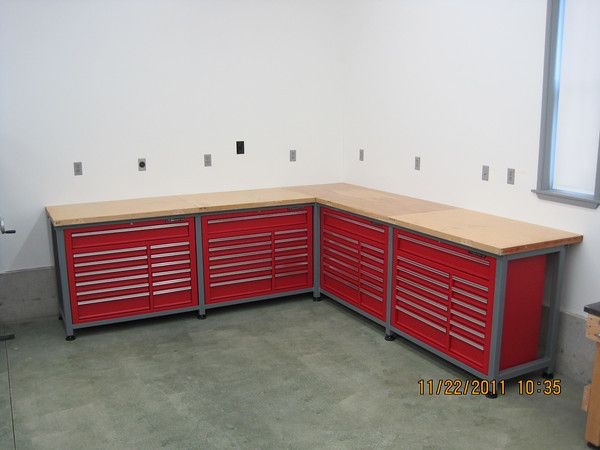

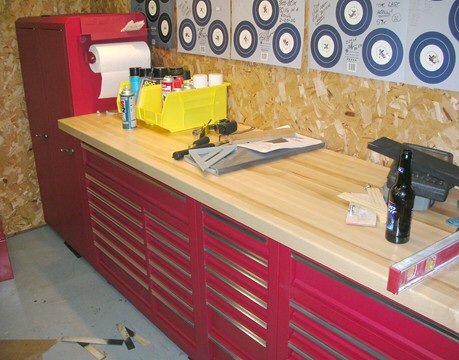

I'm considering a couple of their 44" tool drawers. Anyone with good or bad experience with them?
Roller Cabinet - 44" Red Rolling Tool Cabinet w/ 13 Drawers
I'm think of installing 2-3 of them side by side, one wall of shop, with a work surface on top to time together. Remove side handles so they can be pushed together.
Something like this.
