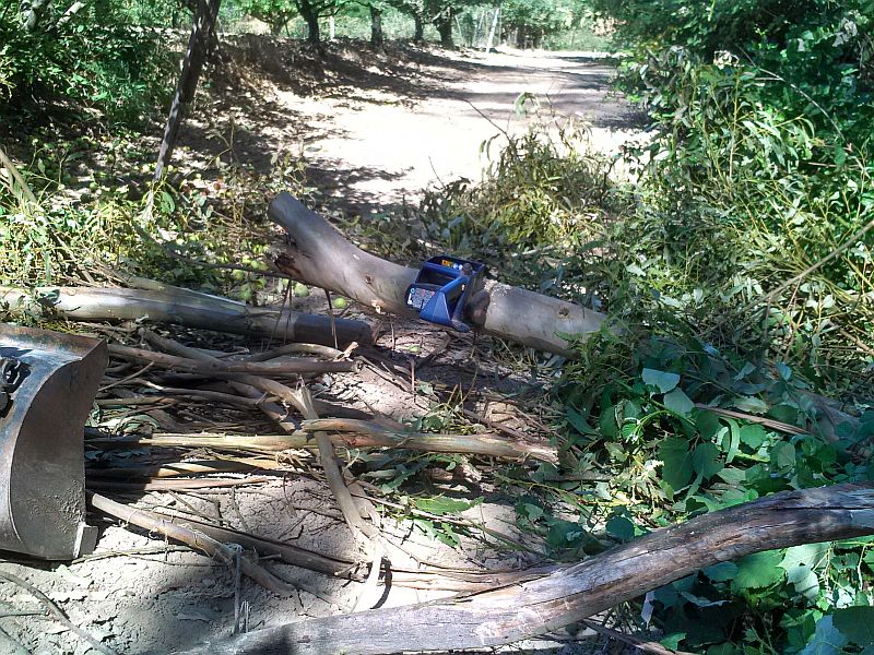

Agree, The nicads from Ryobi 10 years ago were HF-level junk. In infrequent use the Nicads were always dead, slow to charge, then didn't have much run time. BTDT. The present Ryobi Li-Ion batteries and lemon-yellow chargers are a whole new world of quality. And these new batteries fit all the older 18V tools, making them more powerful as well as lighter. Not Makita quality re torque etc but its fair to say they perform as you would hope they would. Good shelf life charged, good torque or time until discharged, etc. Recommended - at least for non-pro applications.
Pro tip: Homelite 18v tools are the same thing as Ryobi. I've bought two thrift-store hedge trimmers @ $5 and seen other stuff on Ebay cheap because nobody knows what Homelite is. (was?)
Photo: Clearing a downed Eucalyptus with the Ryobi 18V 10 inch chainsaw last week.
I agree completely. I almost threw away my Ryobi tools after changing Nicad or NiMh batteries a few times. I decided to give their Li_Ion batteries a try and those have been very good. The tools still aren't nearly up to Makita/Dewalt/Milwaukee quality or power but they are way better than with the older battery types.
