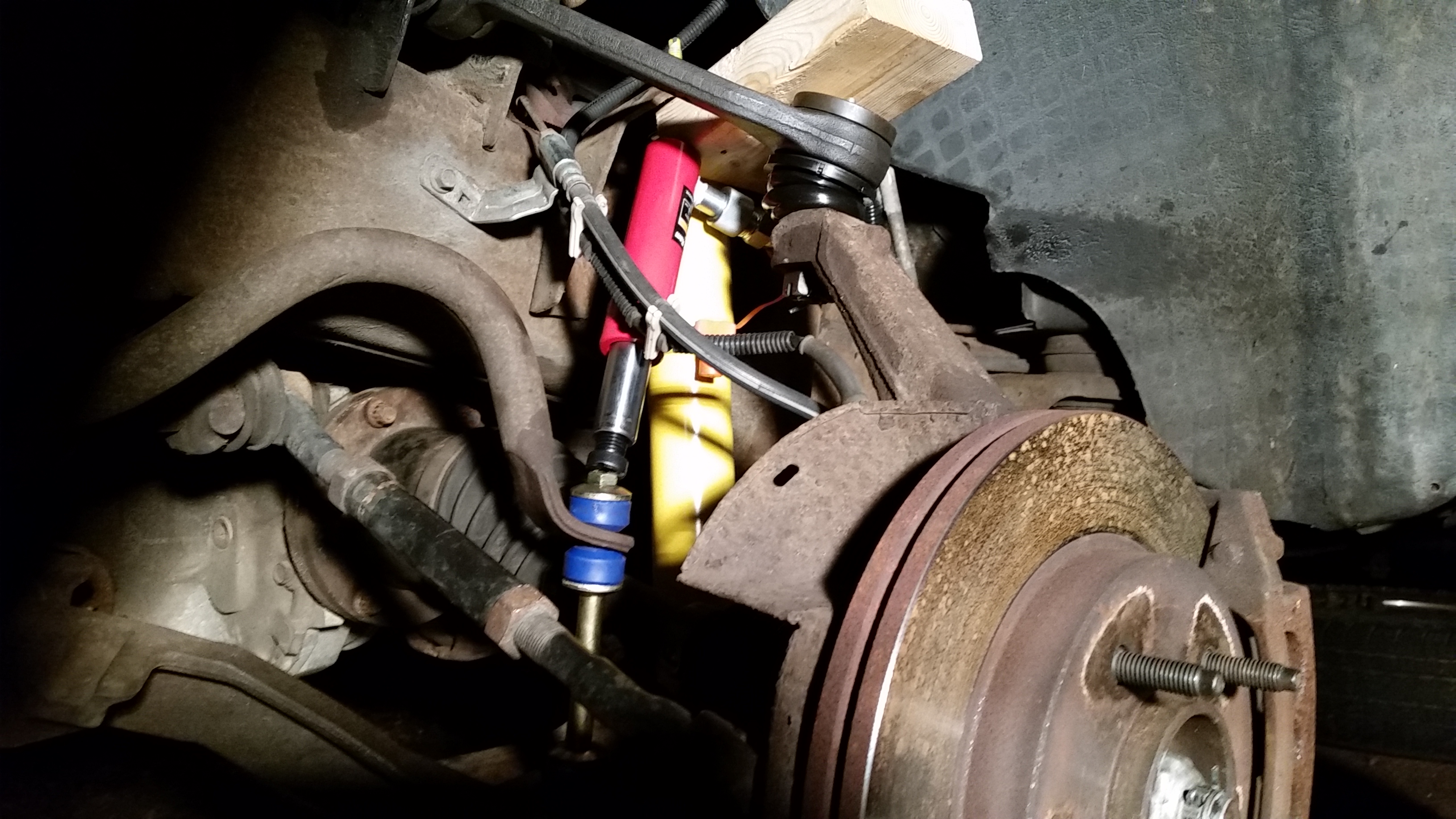

I put basically a new front end on my F150 last fall ... new upper and lower ball joints and to get to the lowers you have to take out the axle which is fun on a 4WD. The stabilizer bars for the sway bar link have to come out. They unbolt but don't come apart very easily due to rust so you have to take an angle grinder with cutting wheel and cut them off.
Replacing the link ... I don't care how big a boy you are ... you can't mash down to compress the bushing enough to get the nut started. Puller hydraulic kit to the rescue! This worked slick! I was able to push down with the small ram in the puller kit and compress these new bushings enough to get the nut started by myself. Now a real mechanic probably has another trick to do this but I'm not the sharpest knife in the drawer so this is the solution I devised:
