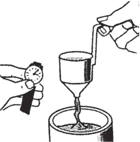

Paint Viscosity Gauge.
My son in law, an artist, has the experience to blend a trial batch then fine-tune after spraying a sample onto a flat surface. If I had to start from scratch I would use this gauge to get in the ballpark.
It should be available at any paint store.

Wouldn't it be nice if you could buy the paint with the correct viscosity for spraying? Wondering if the paint store would do it for you if you asked? I hate dicking around with stuff like that.
