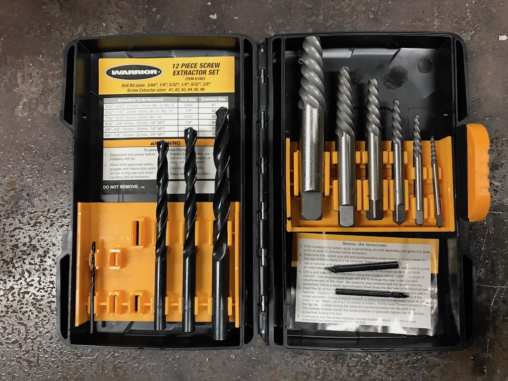

I've had pretty good luck with screw extractors. I'm no expert but I the key is to get a hole drilled in the crapped up screw as big as possible and use the largest extractor. Of course you don't want to go too wide and break the walls out that you're trying to grip. The easy outs I have used don't break but sometime they twist a bit if not large enough diameter for the torque applied.
   / Harbor Freight Tools that don't suck #6,812
Okay here is a HF tool that kinda doesn't suck. I just bought an easy out (screw extractor) set. Very first use, I shattered two drill bits in seconds. Reverted to my non HF bits and drilled the pilot holes. The HF extractor worked perfectly though to back out two 5/16-18 screws in the vice I am restoring.
I've got that same set. I agree, the bits suck. I broke one first use, too. :laughing:
Getting the hole drilled in the center of the bolt is very important.
   / Harbor Freight Tools that don't suck #6,819
Agree.
Center punch the h*** out of it. You might have to grind the stub flat to do this. And be sure to use a left-handed drill bit.
For my last project like this I bought a premium drill bit and ez-out from an industrial-supply place. For most projects HF tools are 'good enough' but this was a broken stud in an engine front cover where botching the job would cost hundreds to remedy. With good tools everything went according to plan. Here's a post I made describing the project including a photo. That wasn't supposed to break.
